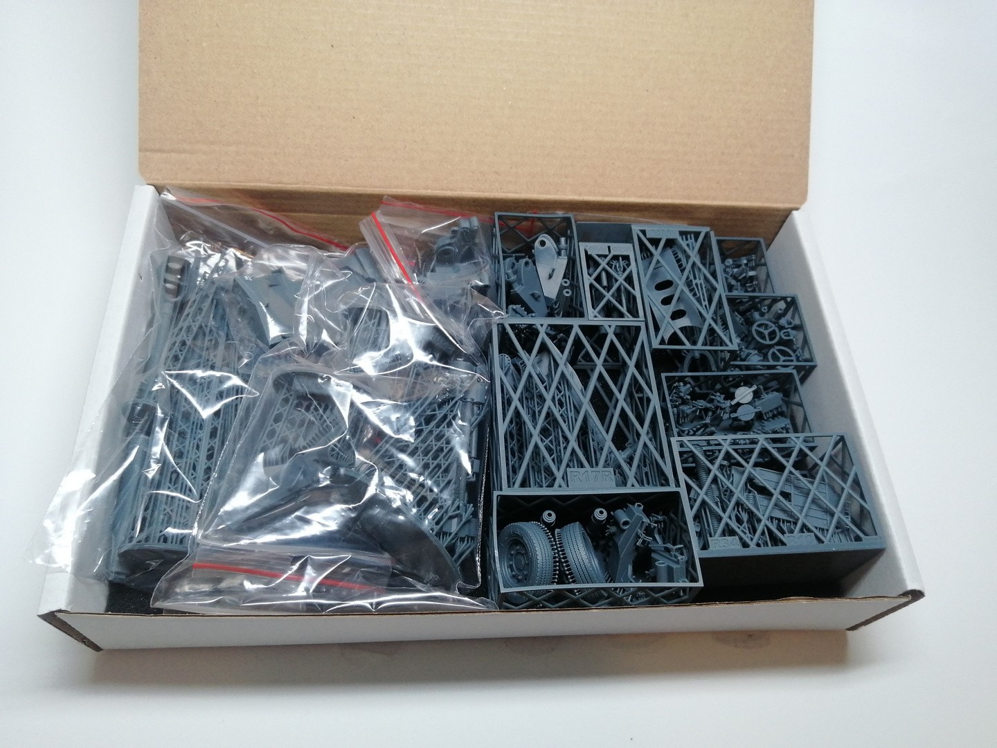

The box measures 26x16x5cm, and features an attractive illustration on the lid. Inside, a top-opening box contains the parts, assembly instruction booklet, two sheets with paint scheme and decal positioning guide, decals, and an A4-sized poster featuring the same illustration as the box art but without the text.
All of this is well protected by two layers of foam. Most of the parts come in the printing tray, with a cage around to prevent them from knocking against one another. A few larger ones are already free from supports.  These loose parts and some of the trays come in individual zip-lock bags.

The print quality of the model is very good, with sharp and very fine details, straight edges and no flaws. However, on some parts, printing bands are visible on one of their sides. In the case of the sides of the howitzer’s body, this is quite noticeable. Although sanding is possible, in my experience it is much easier and equally effective to scrap them with a hobby knife. Furthermore, each part is held by a large number of supports, which are not particularly thin. As the contact points sometimes remain in visible areas, they need to be removed carefully to avoid leaving marks.
What worked best for me was cutting the supports using a wire cutter at the base until the part came away from the print tray, and then gradually free the part with a sharp modelling knife. It’s a job that takes time, care and patience, but it’s better than breaking a detail or having to fill in marks. With the wheels, however, the system is different, with a myriad of extremely thin supports. These come away much more easily and without leaving marks. I guess it’s a technical issue, but if all the parts came with these supports like the wheels, cleaning them up would be much easier.

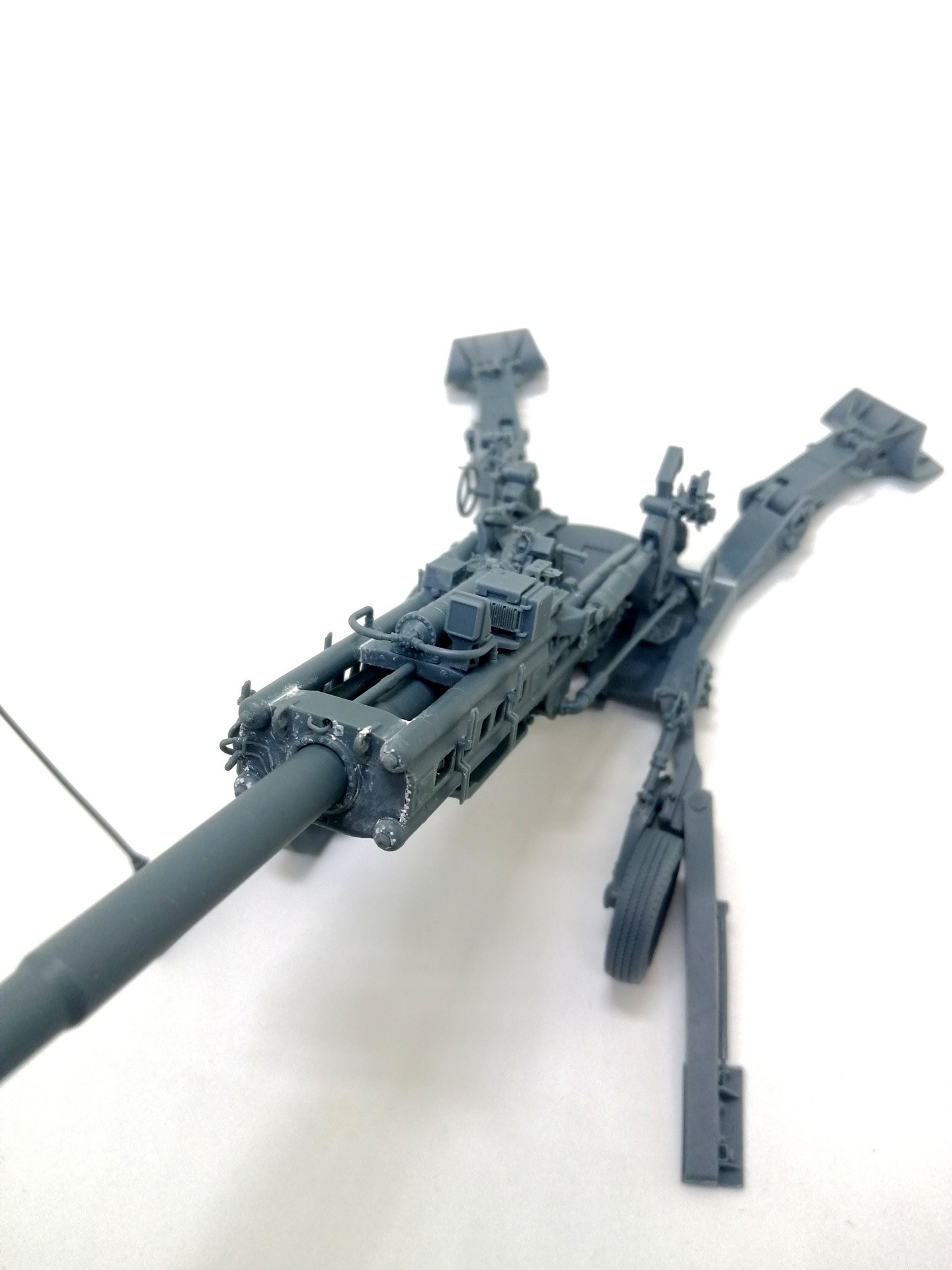

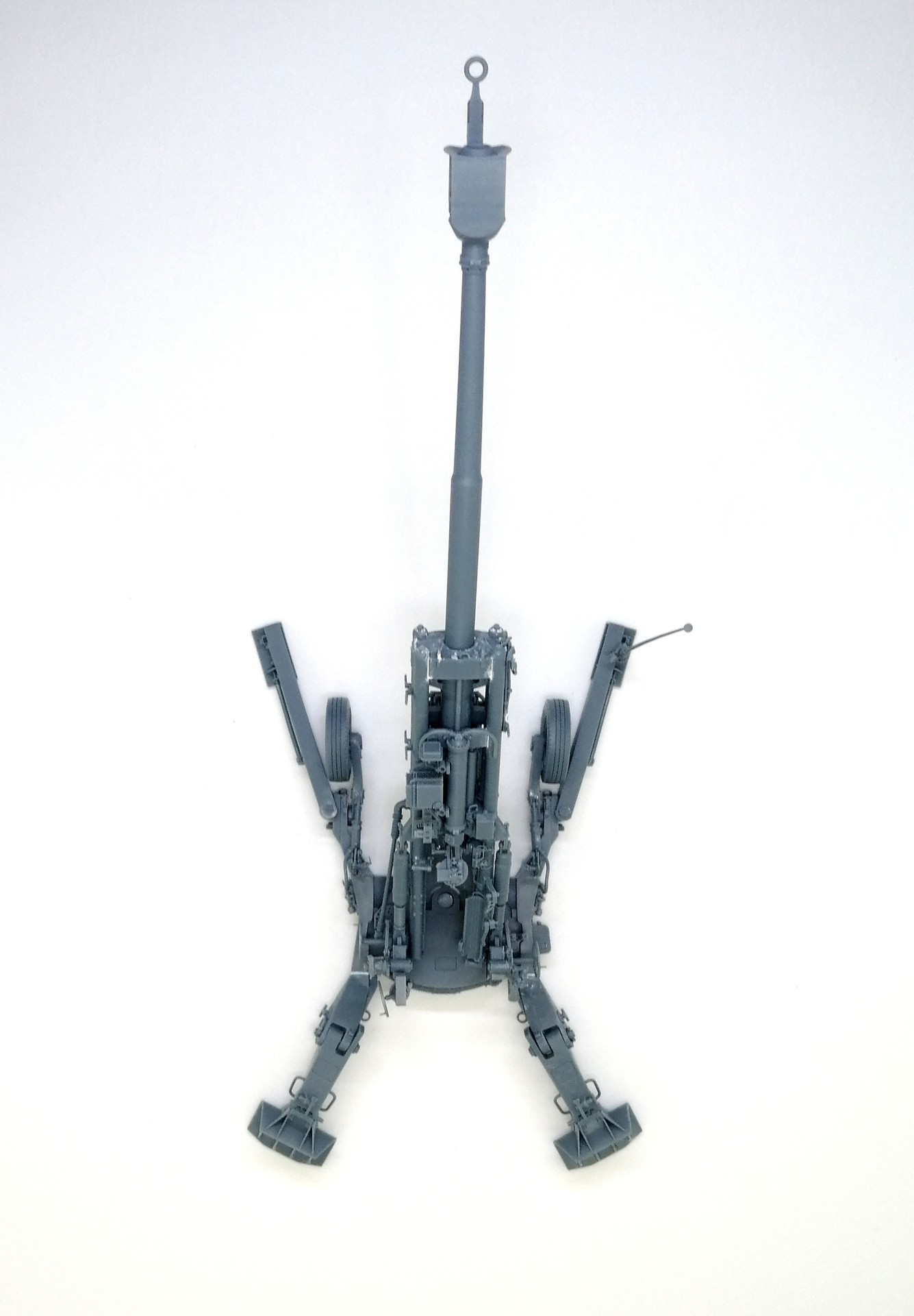

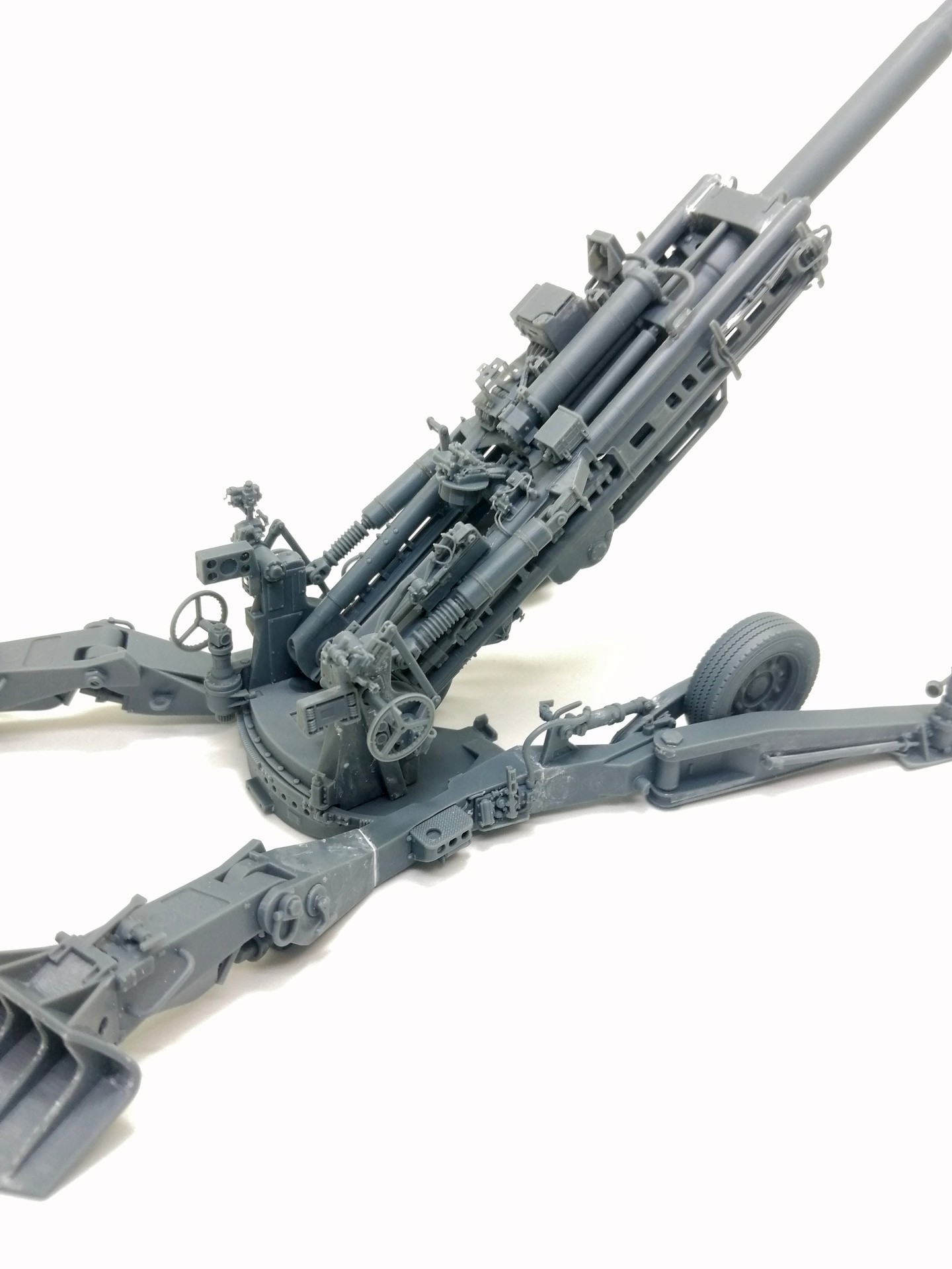

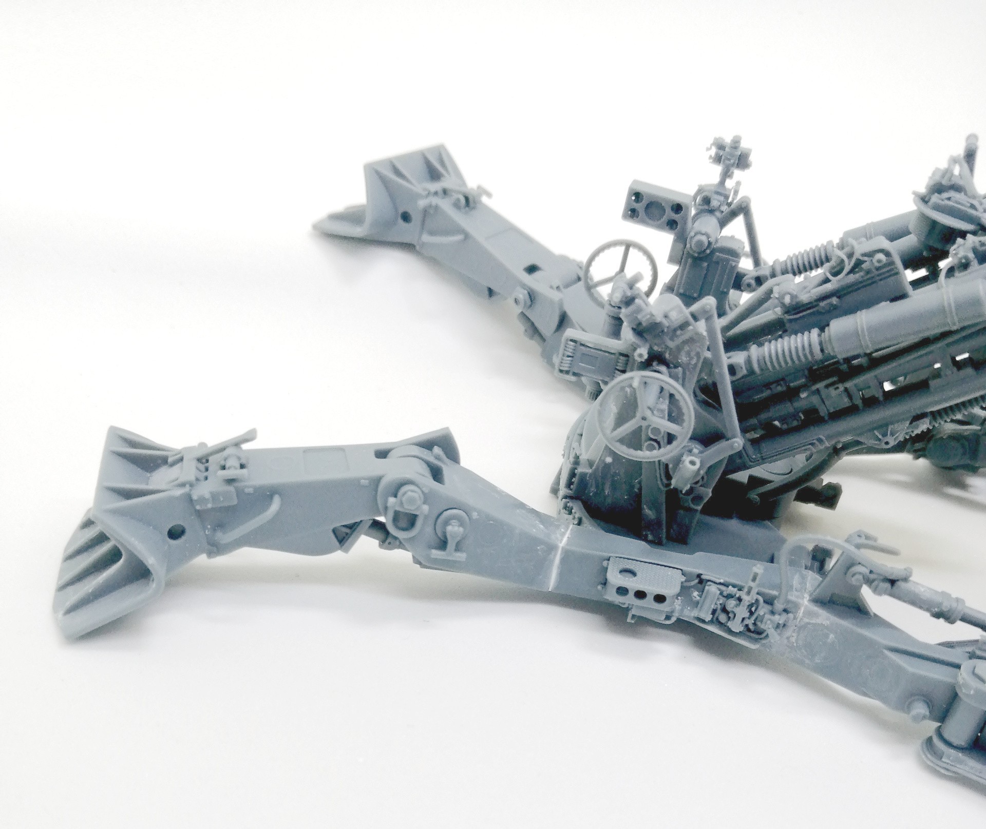

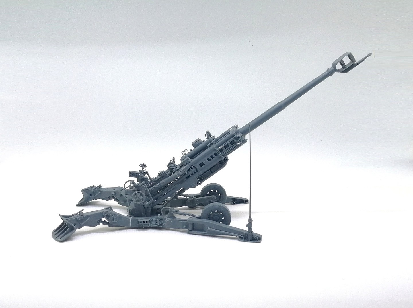

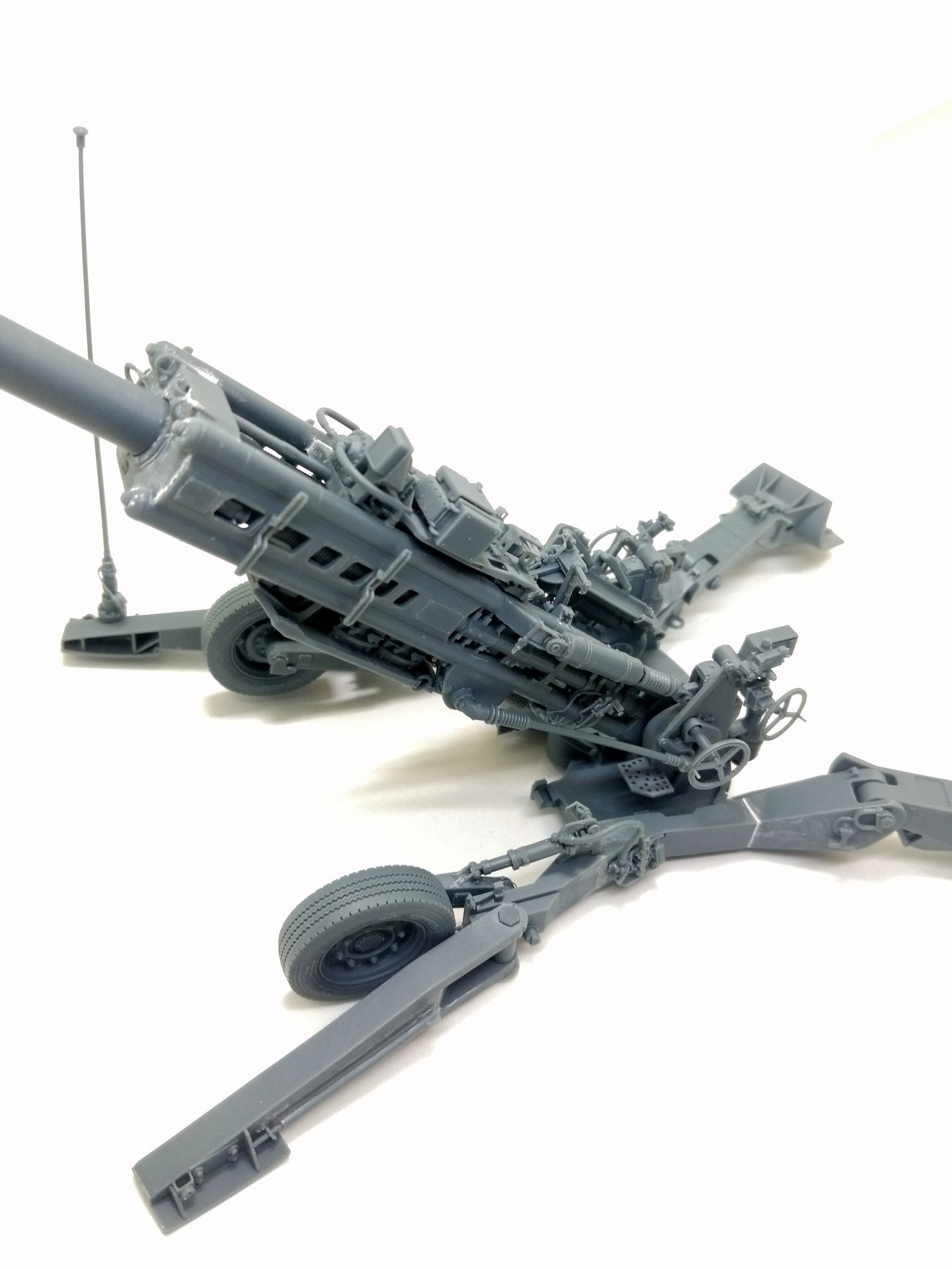

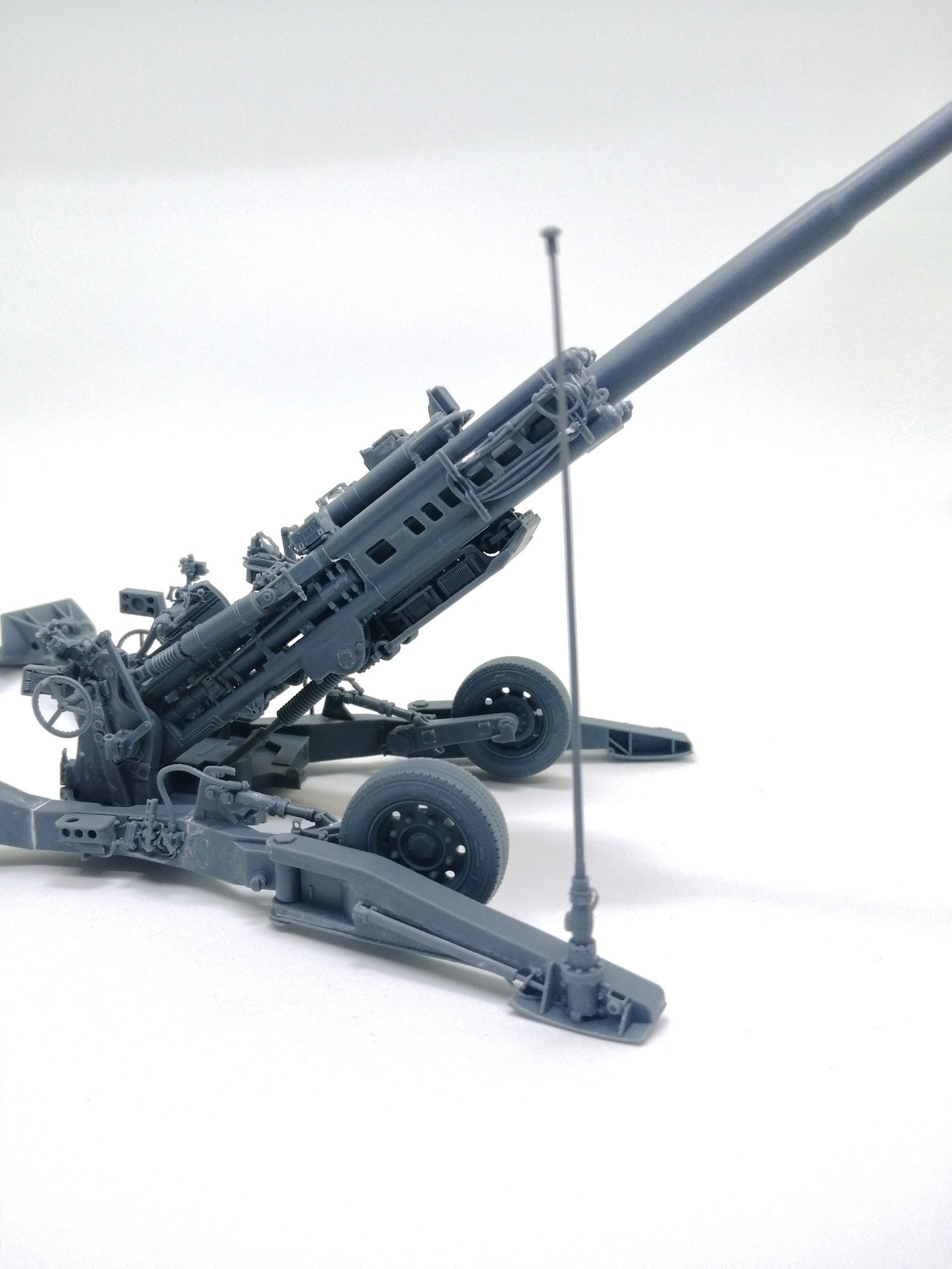

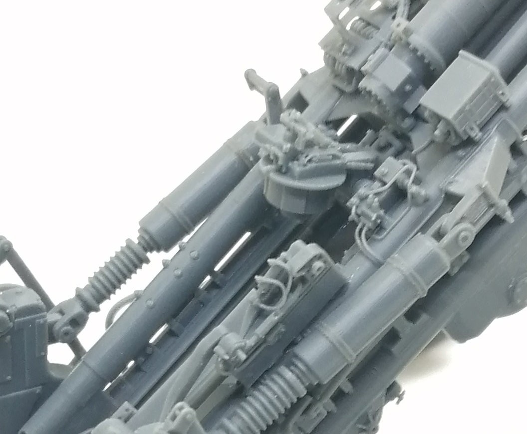

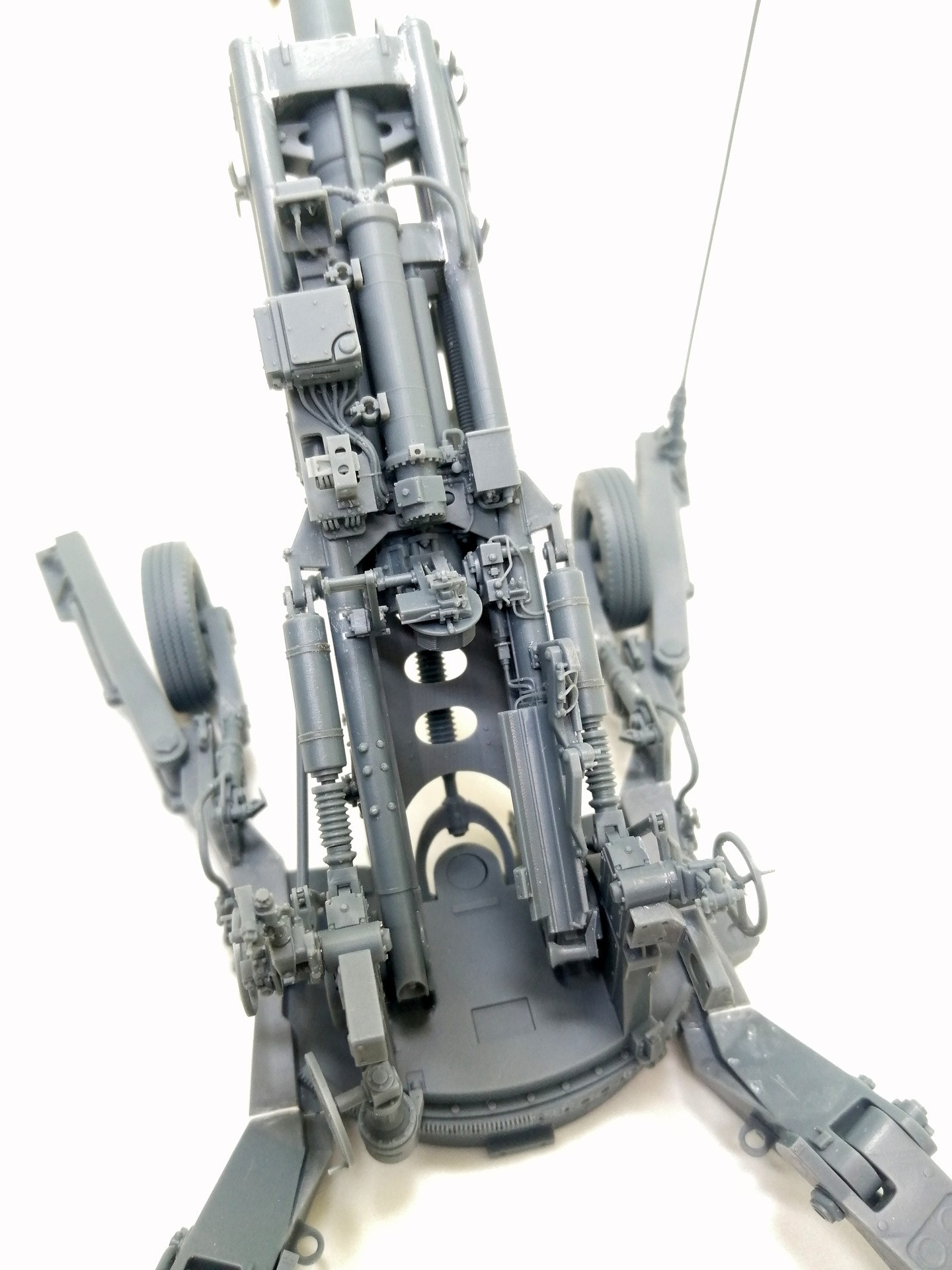

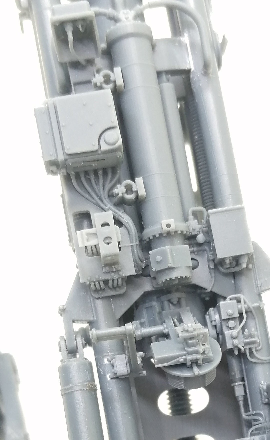

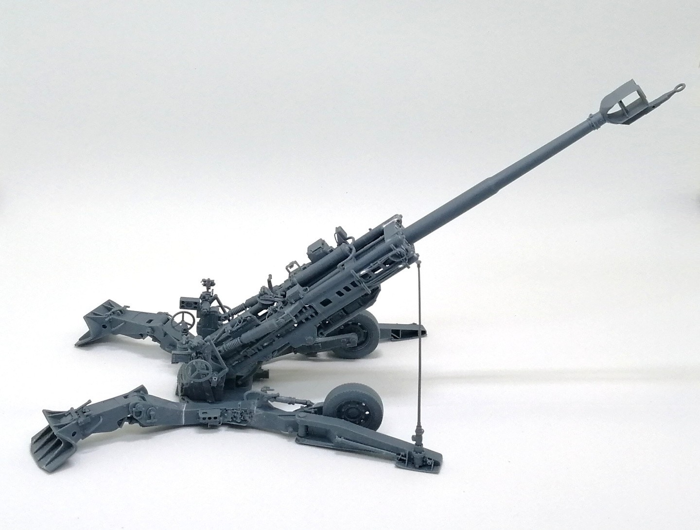

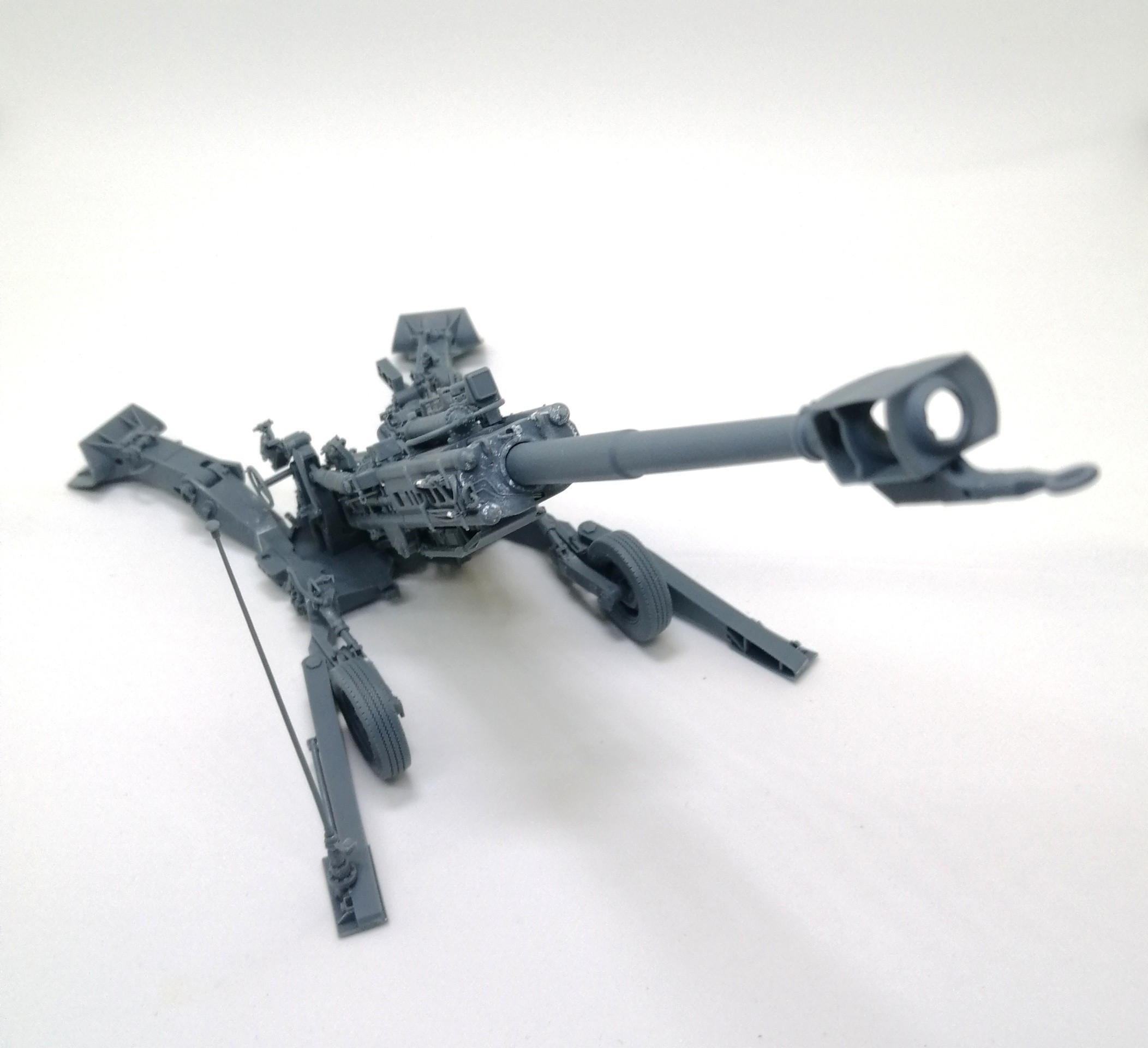

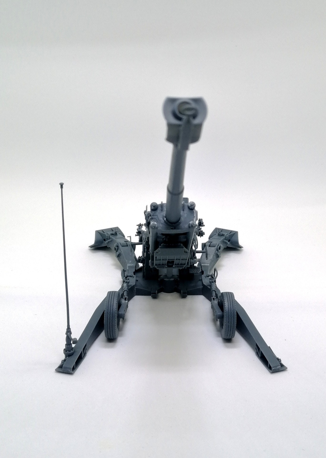

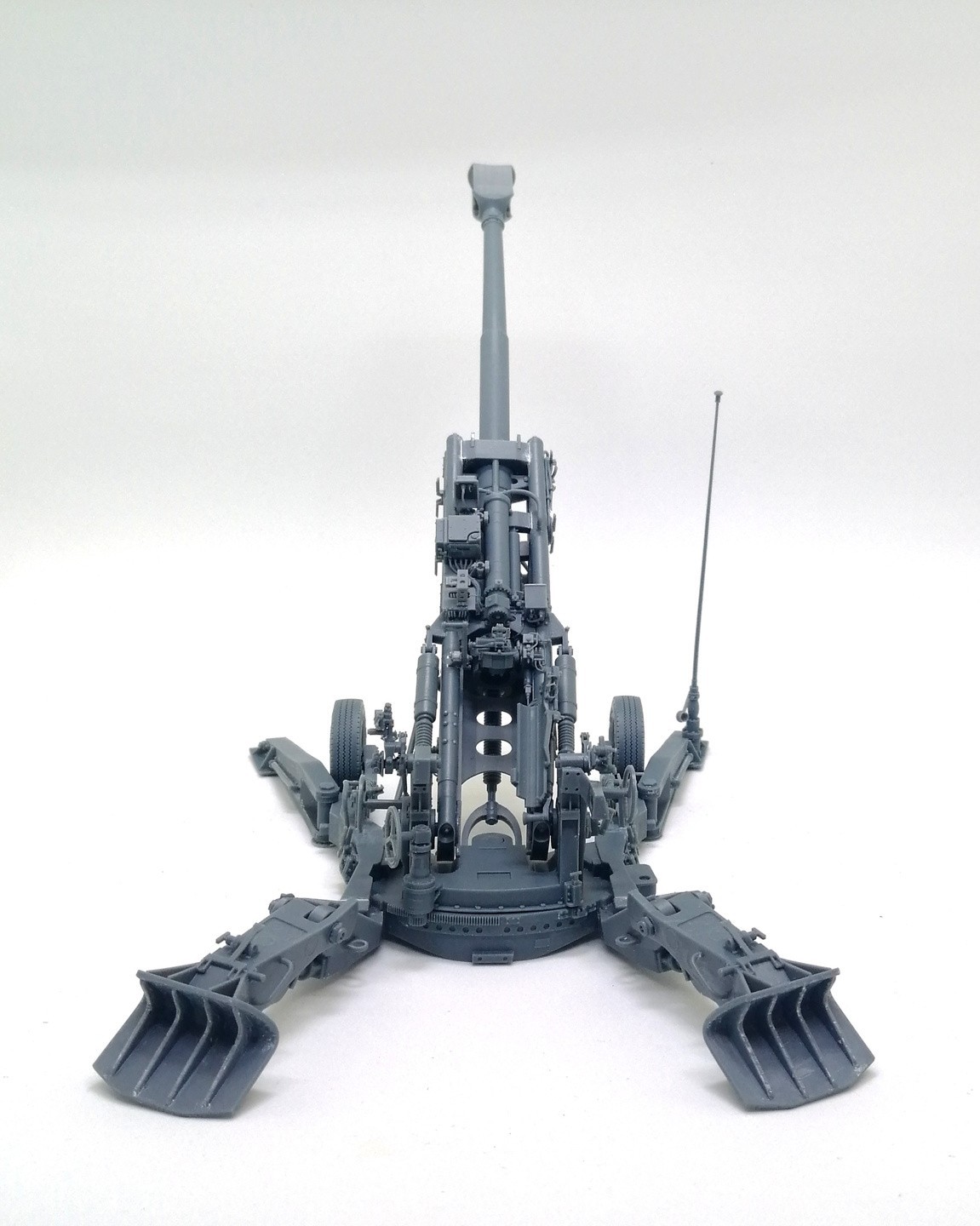

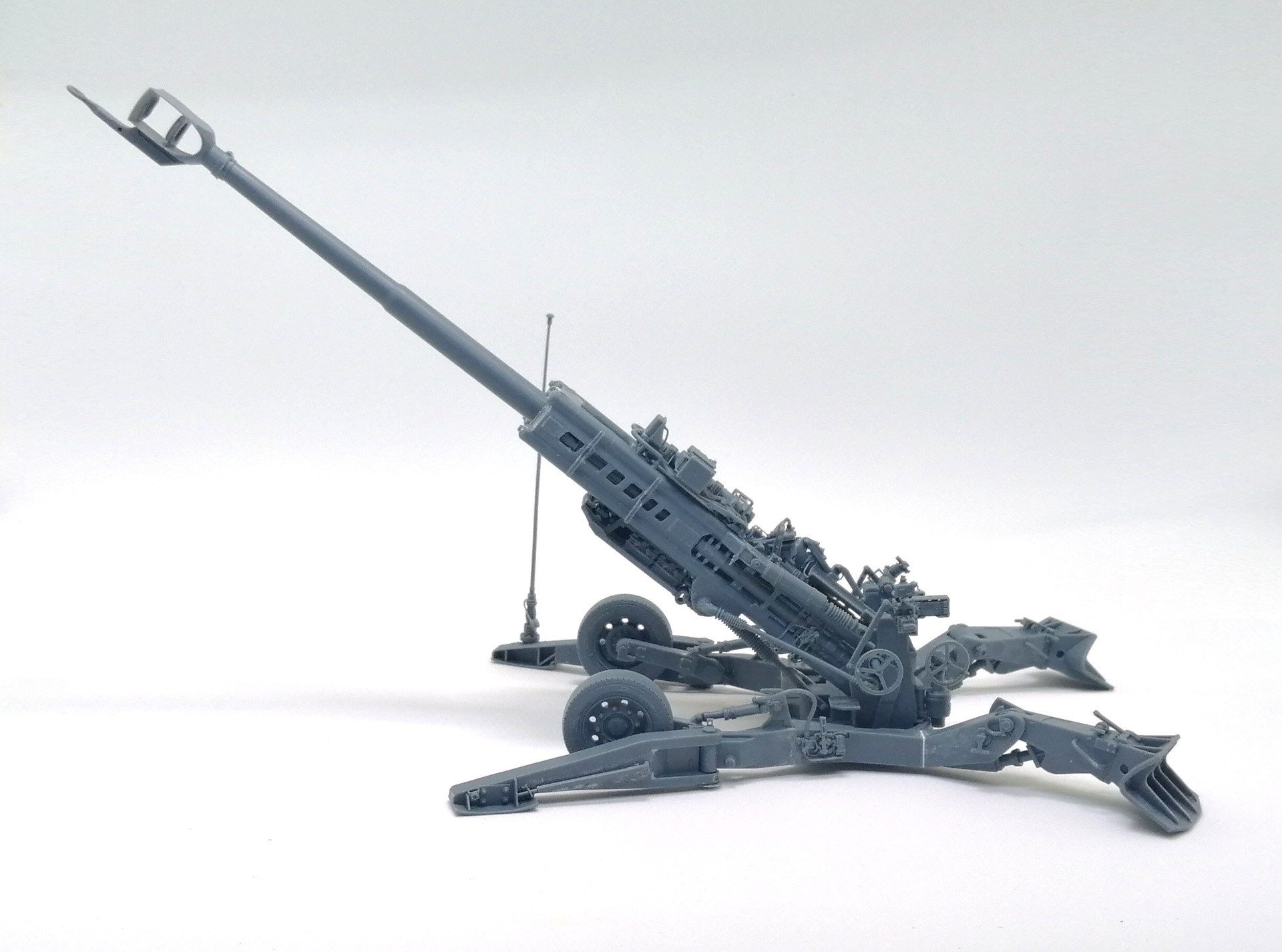

Here are some general views of the kit once fully assembled.

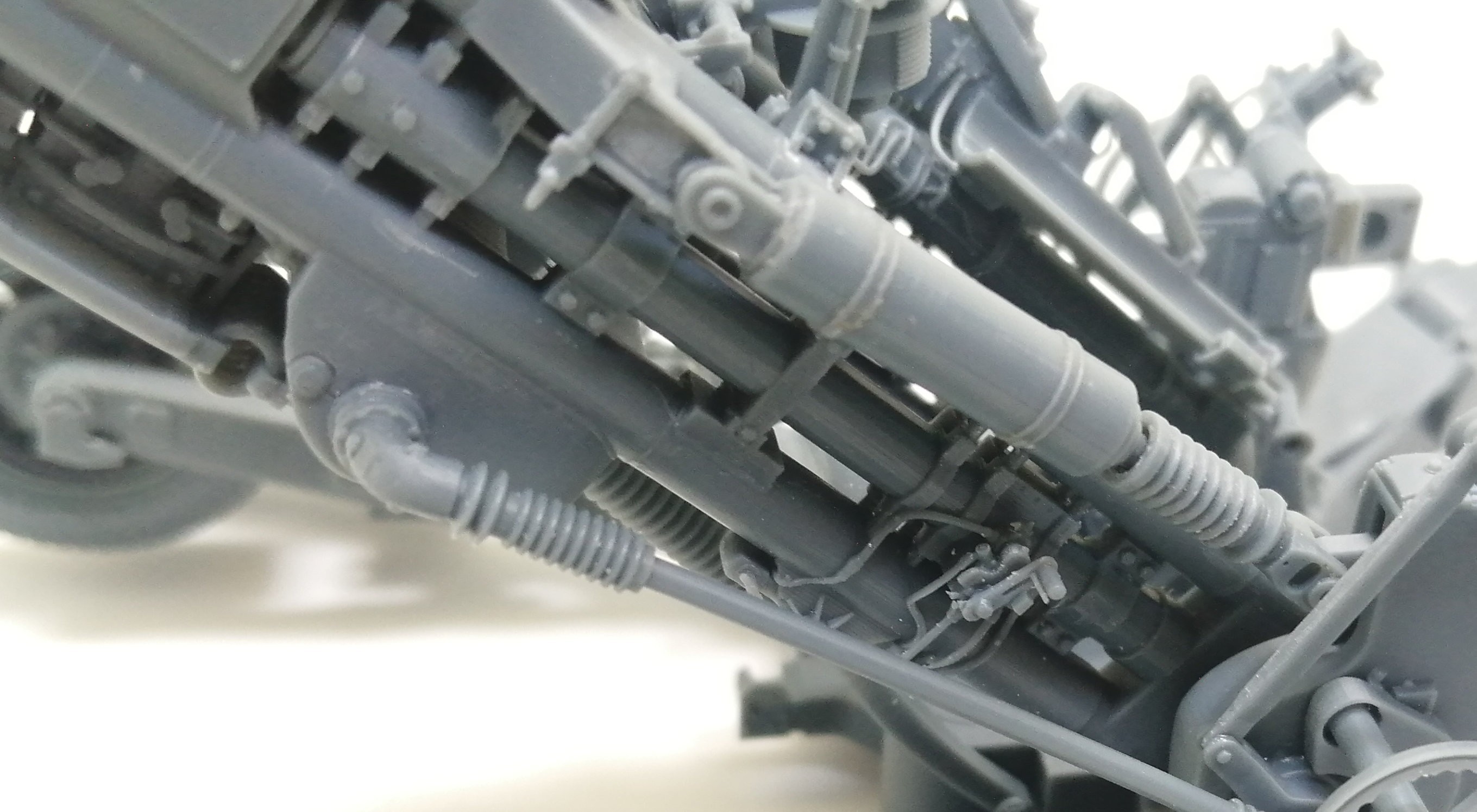

And now some in detail. It is worth to see  all the cables, hoses and the rest of delicate details.

An M777A2 kit with excellent detail and sharpness. Removing the supports  from the  parts takes a bit of effort, but apart from that, it’s very pleasant to assemble with a reasonable number of parts And the result is truly spectacular.
