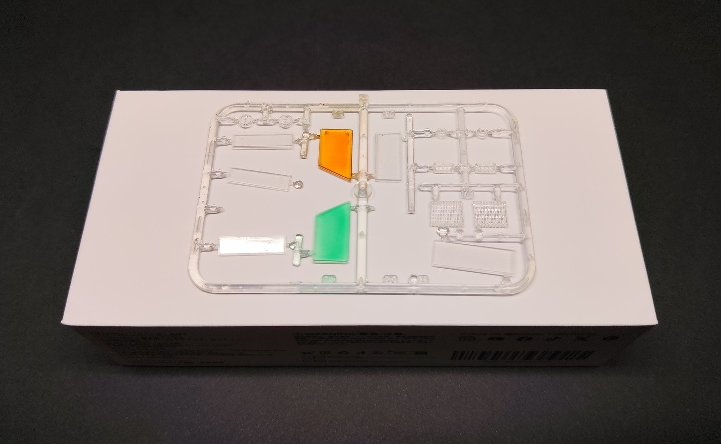

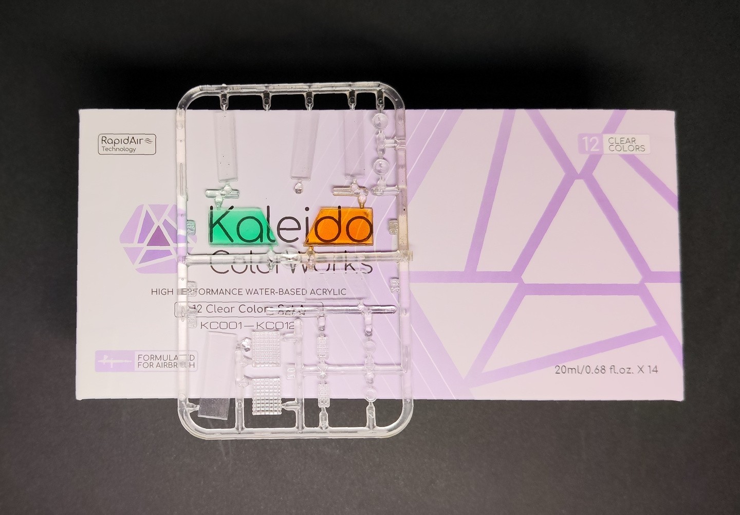

Within the range of airbrush paints from Kaleido, a brand of the Gaahleri group, we find the translucent series (Clear Colors). Their main use is for painting transparent parts because even when applied in several layers, they do not opacify the part.
The set comes in a long  box containing 12 x 20 ml bottles, plus two more  of thinner and cleaner.

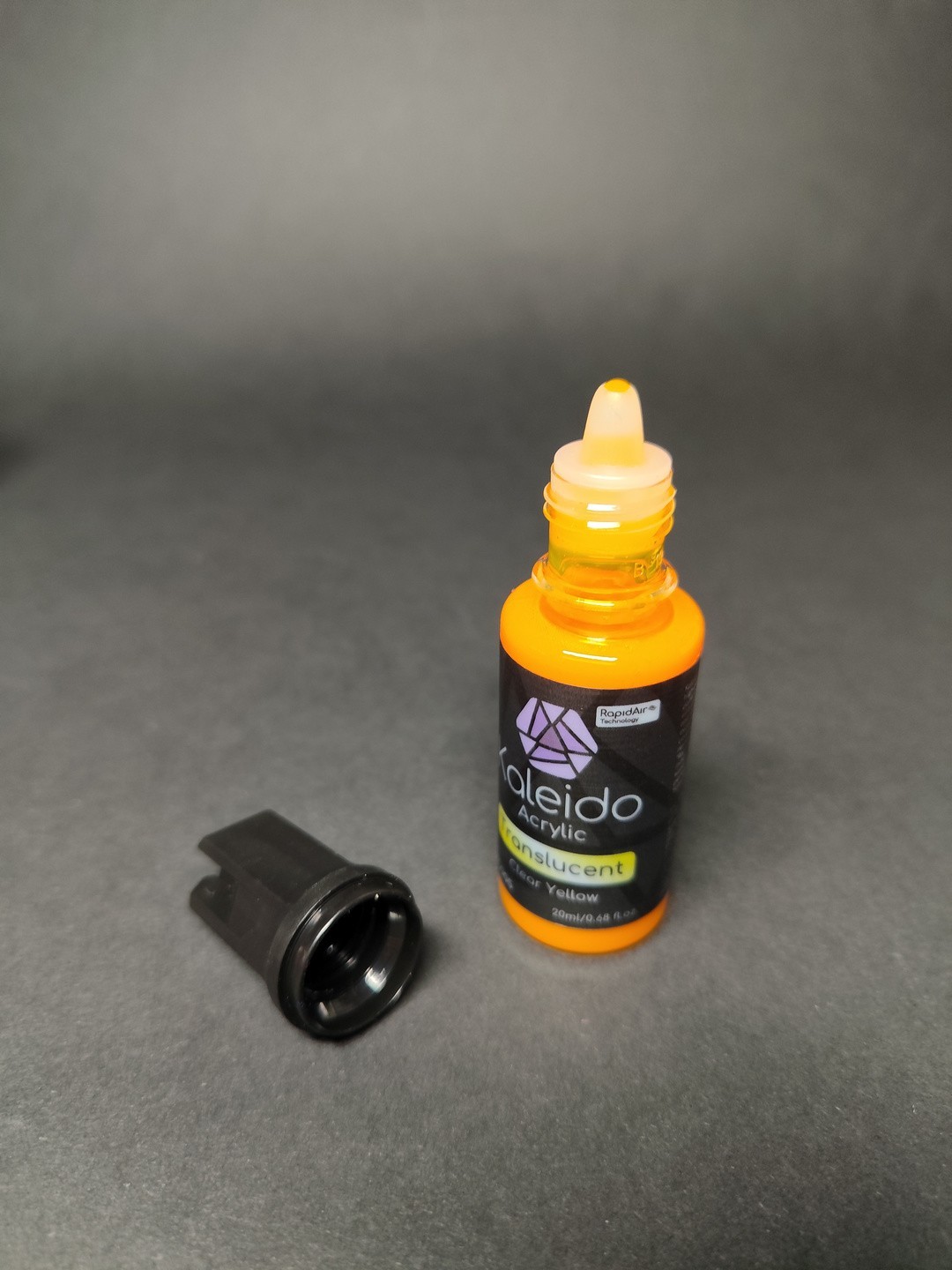

The bottles have a ball inside to aid shaking and feature a dispenser nozzle at the tip.

The finish is glossy and very smooth, yet transparent.

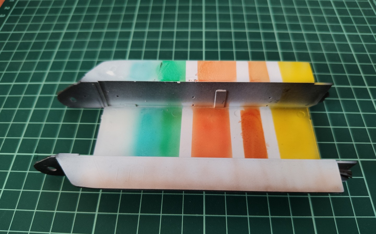

Additionally, they can be used to alter the shade of a base colour, for which it is advisable to add some thinner. In a quick test on white, a light coat is sufficient, as seen with the blue on the left-hand side. The rest have two,  or even more coats on the inner section, where you can see they have already darkened considerably.
At the bottom, there is a test of dusting using the brown shade.
