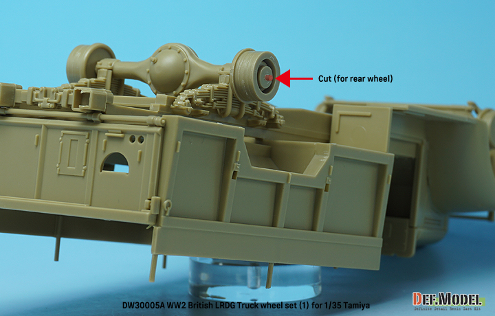

This set of resin wheels was designed as a direct replacement for Tamiya vinyl tire/plastic rim combo. The front wheels fit without any modification necessary, while the stub on kit part C45 should be trimmed to fit rear wheels. Image on DEF Model website could prove helpful: link.
