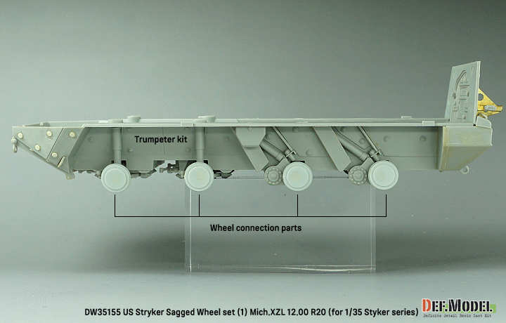

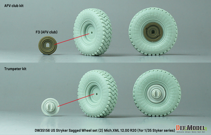

This wheel set is designed as a direct replacement for AFV Club kits. An adapter supplied in the set should be used when installing the wheels to Trumpeter models. DEF Model website provides images which can be of help: link and link.
