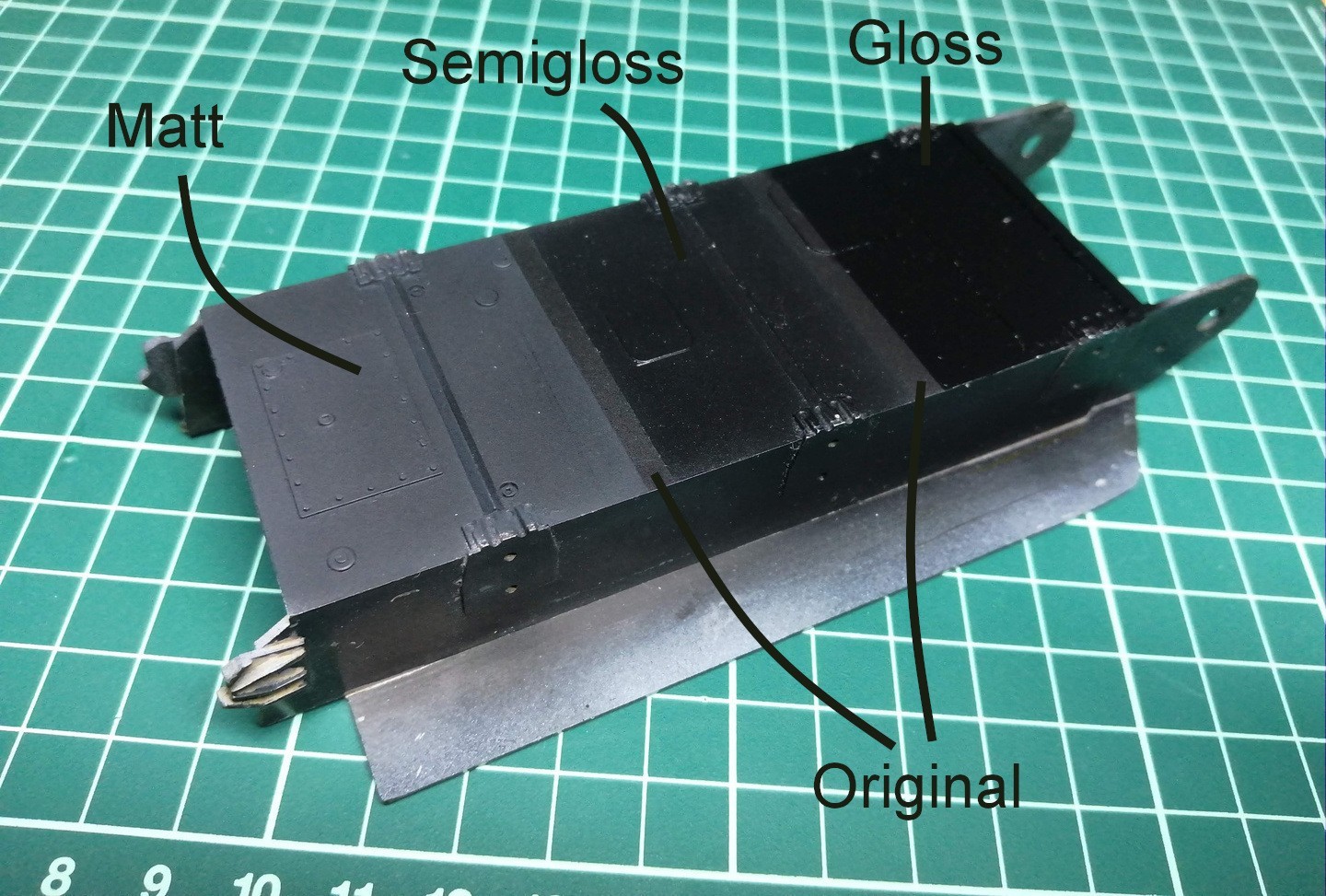

Application is simple and hassle-free; I did not experience any clog in the airbrush. Applying them with the airbrush produces only a light smell. The finish is fine and not too exaggerated: the gloss is not mirror-like and the matt is not ultra-matt.
Here below you can see the effect of the different finishes on a black acrylic primer

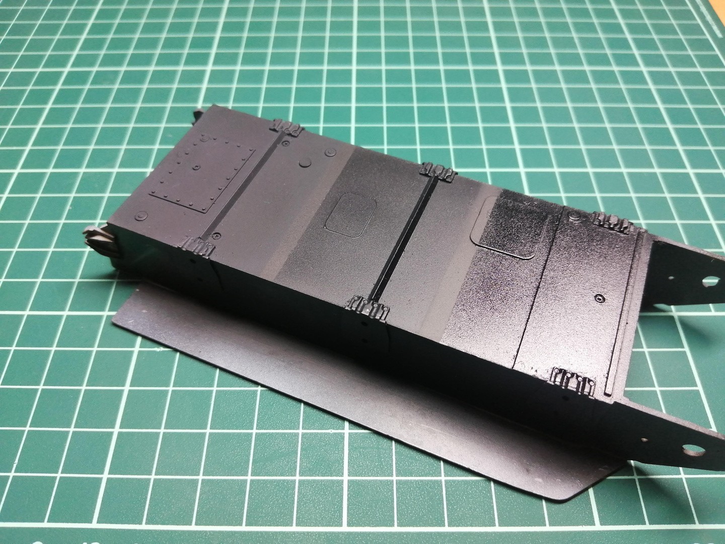

This photo  has the light source angled to reflect  better and check the shine of each finish.

Mechanically, Kaleido varnishes present no problems. They withstand being scratched with a fingernail and vigorous rubbing with a finger. Tamiya masking tape adheres to and peels off without leaving any marks whatsoever.
Chemically, they are unaffected by water, enamel thinner or Mr. Color decal setter.
As far as I have been able to test, they are safe for sealing the base paint .
