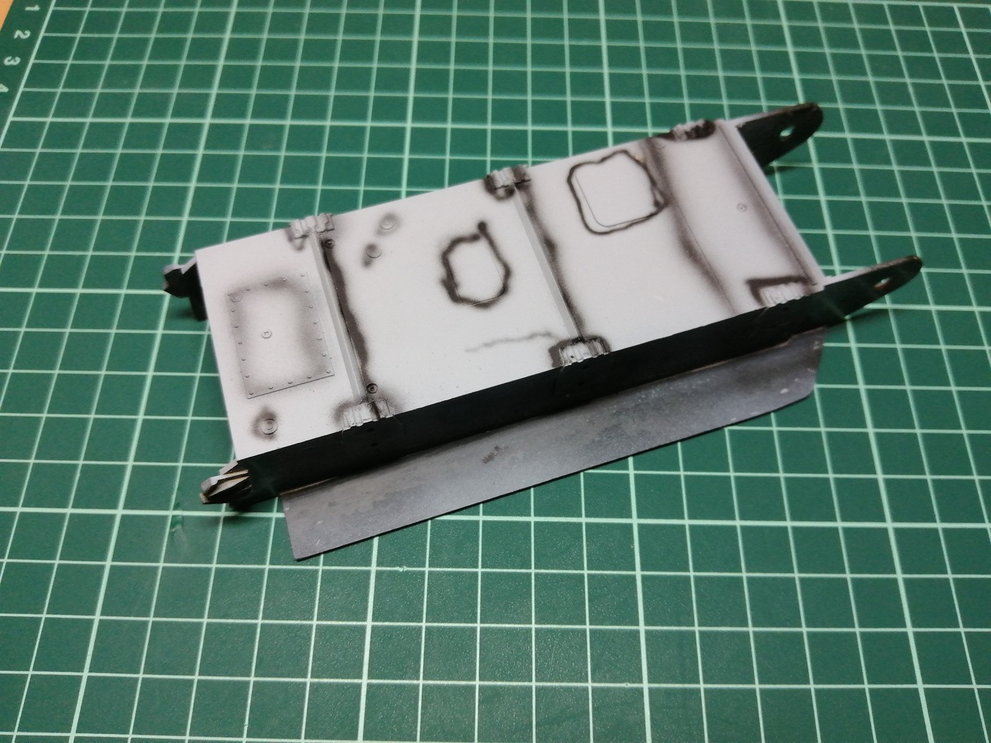

Test of light grey with black shadows using my less-than-steady hand

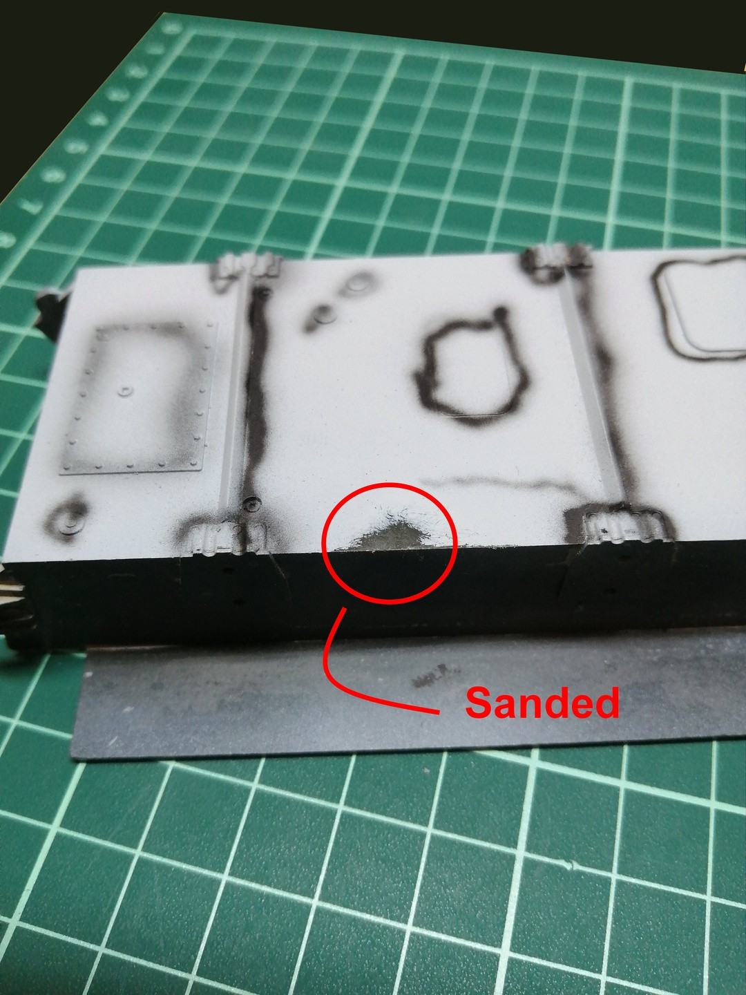

Sanding with 400 grit does not produce steps or surface tears.

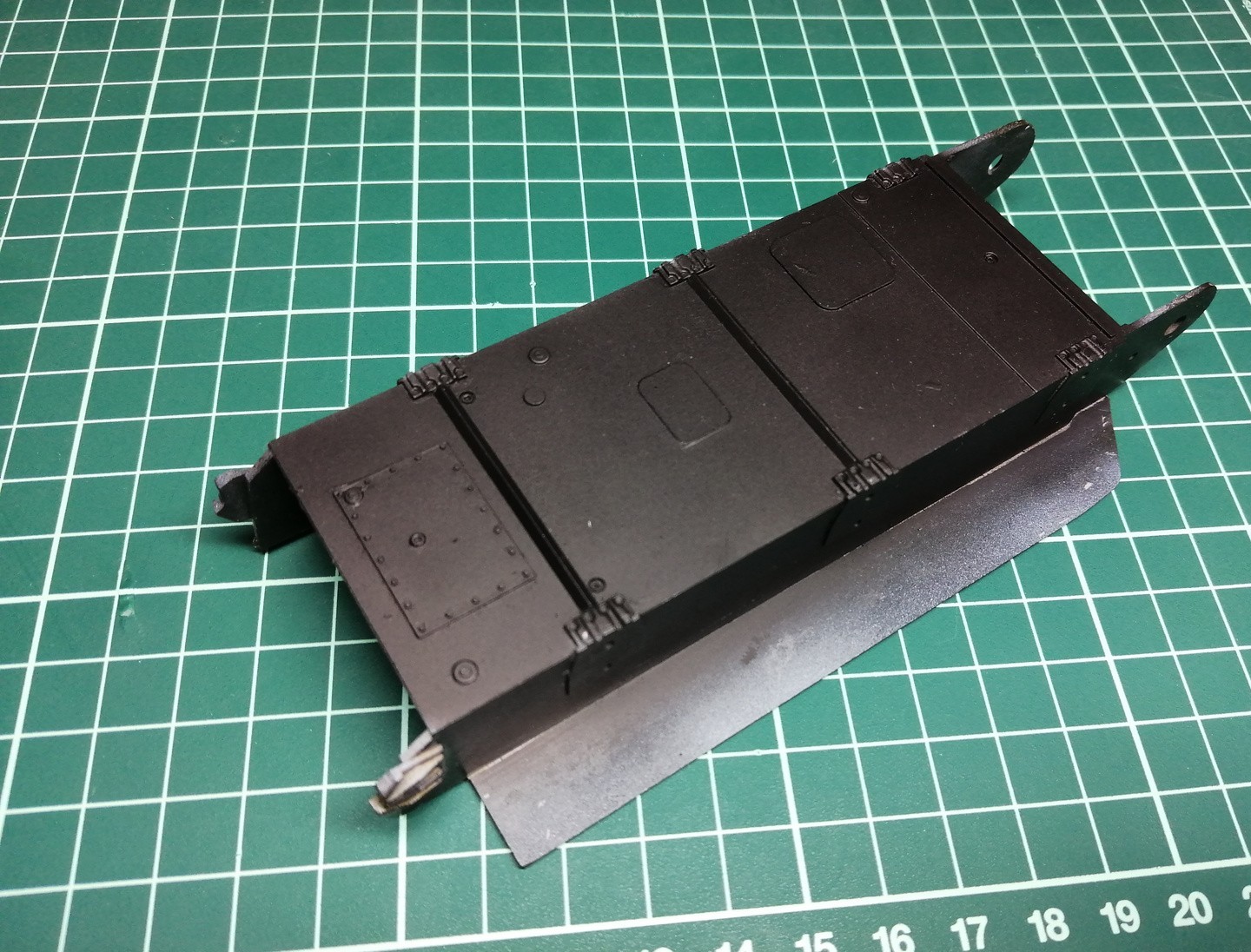

Hull re-primed on top with black, perfectly smooth and covered

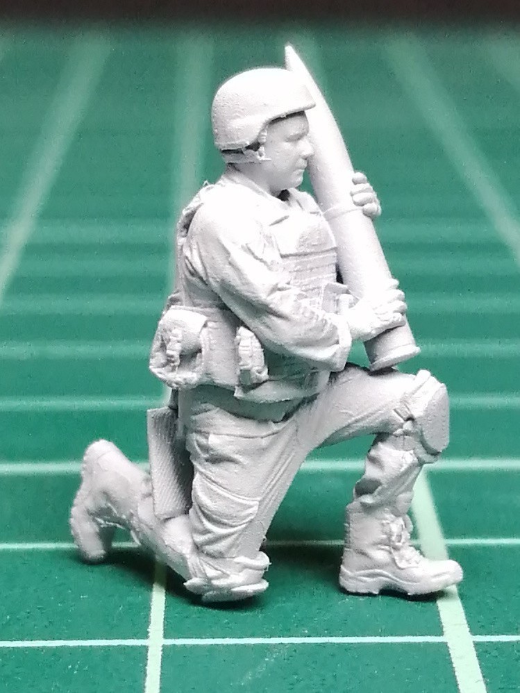

Testing with the delicate details of a 1/72 figure. Note how everything remains clearly visible.
