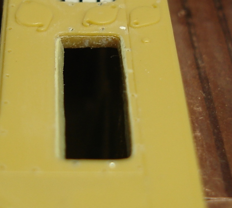

After a hard work with grills I have this variant. Was very hard to do all that and especially to separate upper deck . This is my final attempt. Three to go. Later I will do the grills bottom.

Little add on. I have installed the bottom. I just need to fill the gap and change the technology. Bottom first and the grills - second.

quite a lot of work, but it is a big improvement Artyom.

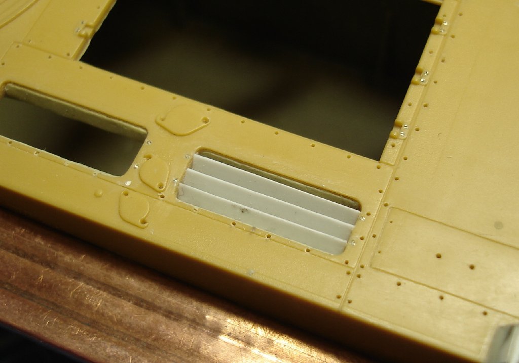

Yes those white plastic grille strips refused to be straight, I’ve had the same problem - the only way to line them up is to glue them to a base panel with spacers in between until the glue dries. Which is annoying because the whole point of the vents is to allow air to circulate beneath so there should not be anything in the way. But I think it’s the only solution, neat job and good luck with the other 3!

Hi,Tim! I agree with you. It is a hard work. But for me was much more harder to separate the plates and glue 0,4mm rivets.

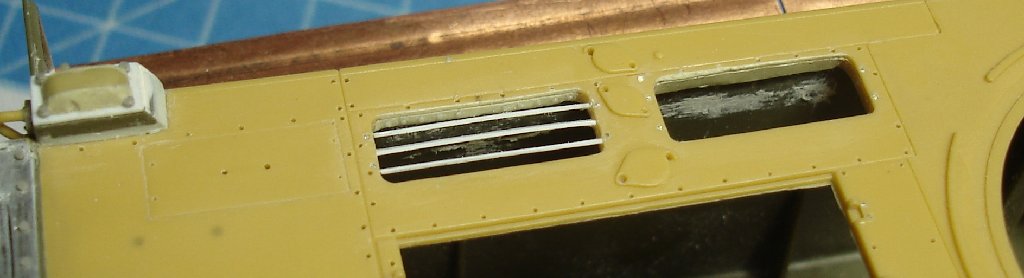

Finally I've done it. Looking forward to work on air cleaners next week.

Significant improvement. Worth all the hard work Artyom.

Hello,Peter! That wasn't easy for me to do this and to get grills be strait. And those rivets,separate plates,sided with angle. Uff. At last it came to an end =))))

Ouch I can imagine some of the pain you must have endured to achieve that symmetry – very difficult…and excellent, well done!

Hi, Tim! Thank you. That wasn't easy. It's true. But this was a really good experience for me. I think this grills makes this model much more attractive and accurate.
