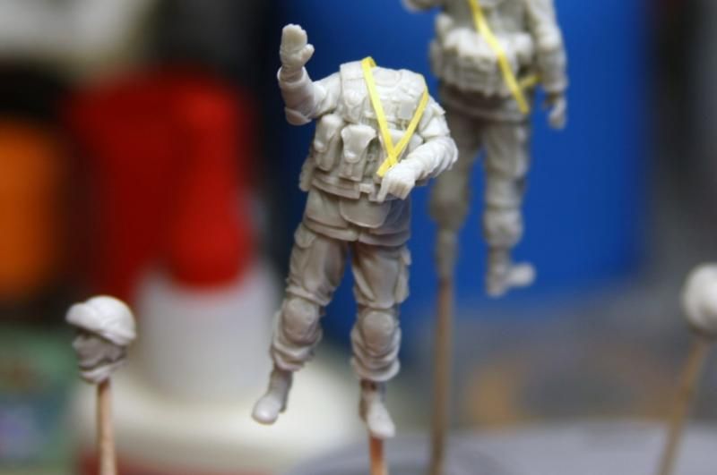

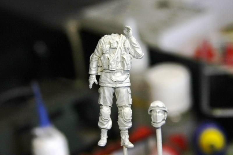

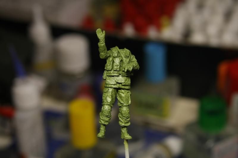

So here are the assembled figures- one had a pair of binoculars but I've left them out of my build. The only things I've added are the weapon slings- a few of the troops seemed to favour both their sling connections on the AK butt instead of the more traditional butt and forestock connection so thats what I am depicting.

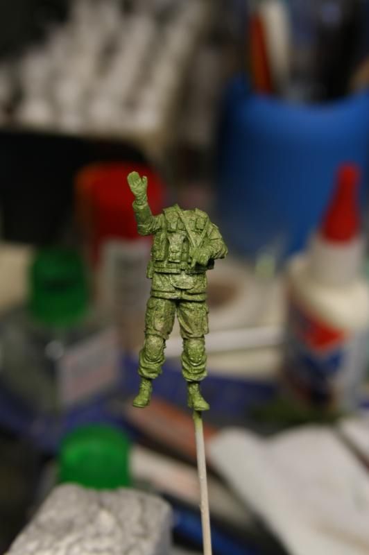

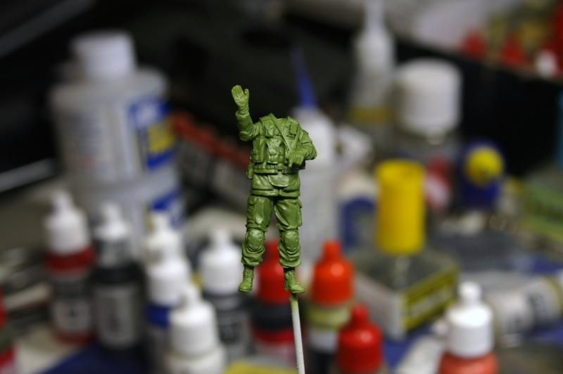

And after some primer:

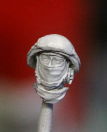

The kits also come with very small radio mic booms for speaking into and a small resin wire coil connecting the handset to the earpieces. However, I'm not sure the sculptor has the coil shape correct- I think some of them may have just been a long wire, not a coil. I have some more references to look at for this.

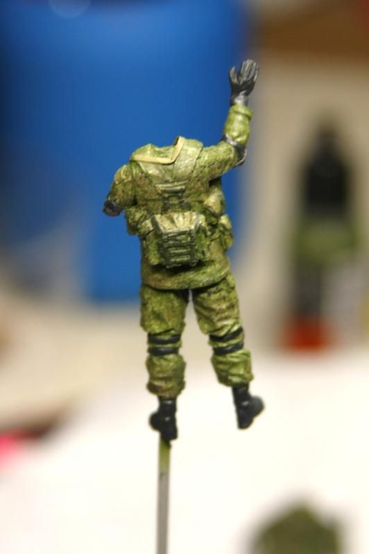

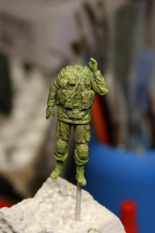

So- to painting. I've done US ACU pattern before and been sort of satisfied at the result. It was painted by hand and it is a real difficult subject to get looking even semi-okay. The US pattern has such a level of clarity and size in its pixelation that the pattern, even in 1/35, is best attempted by hand so the sharp dilineations between colors are captured to some extent. This Russian pattern though, is trickier. The pixels are much smaller and very different to the US ACUs- it is also much more subdued in terms of the color differences- like I said at a distance it appears merely green.
I decided to experiment a little. I chose Russian 4BO Base Green from an old AK set (when Vallejo made their stuff) as my base. It is a very mid-green and gave me a decent place to start so I can darken or fade the uniforms later on.
Then I took some Ammo by Mig paint, Light Green Khaki from their Russian AFV colors set, gave it a bit of dilution with water on a brush and then used the brush flicked against a steel ruler to spatter the figures and helmets with fine flecks of paint. It turned out better than I expected- it was subtle but didn't completely fade into the base coat. I think it does a decent job of tricking the eye into thinking there is a digital pattern (or a very fine camouflage pattern) on the uniform. The light green khaki I spattered liberally as it seems to be the second largest color in the pattern besides the base color.
Next color up was a wood or medium tan brown-ish color. I used Andrea Wood and spattered it again only not so liberally as before.
Then, and most sparingly of all, I spattered Vallejo Black Grey in some areas.

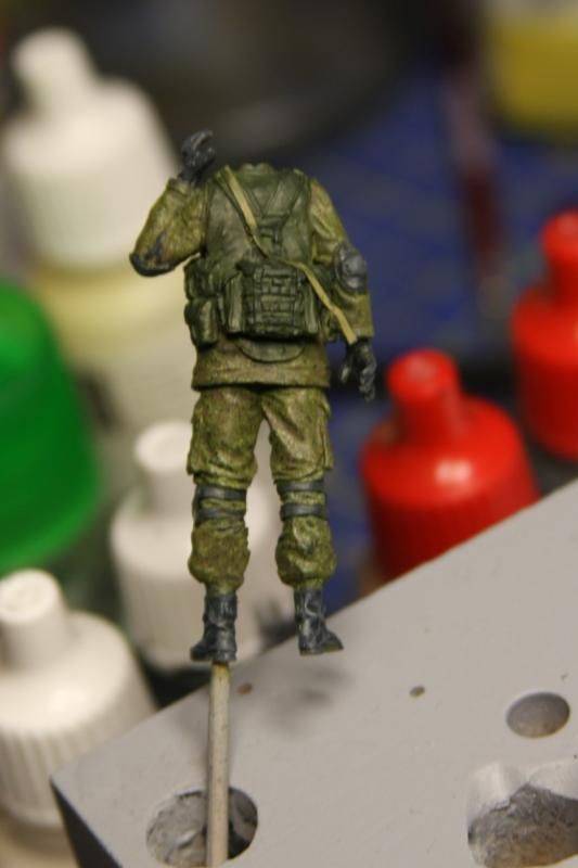

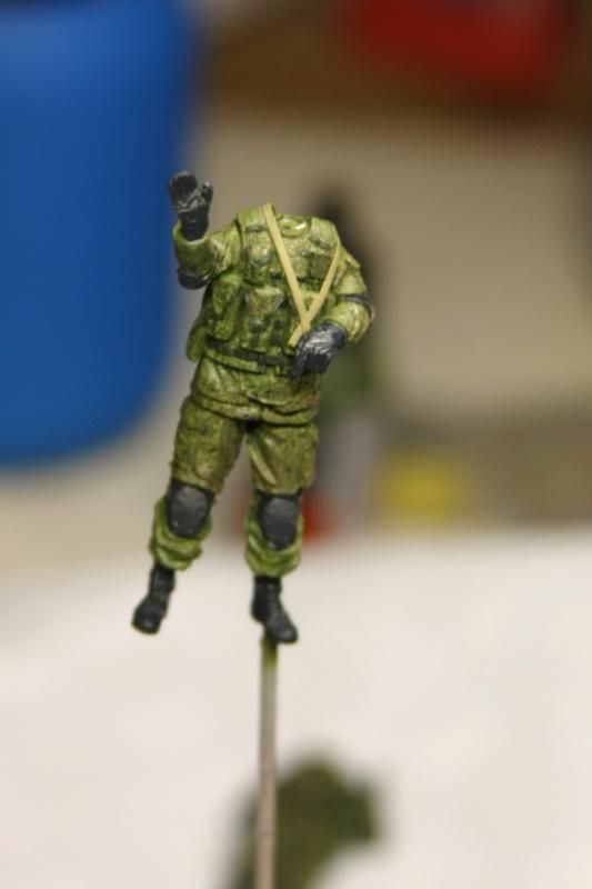

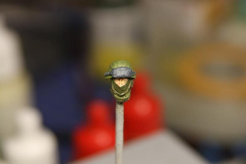

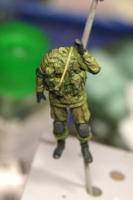

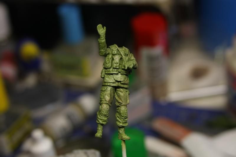

And here is the other figure and the two heads (I have also now painted their jacket collars in the same digital pattern):

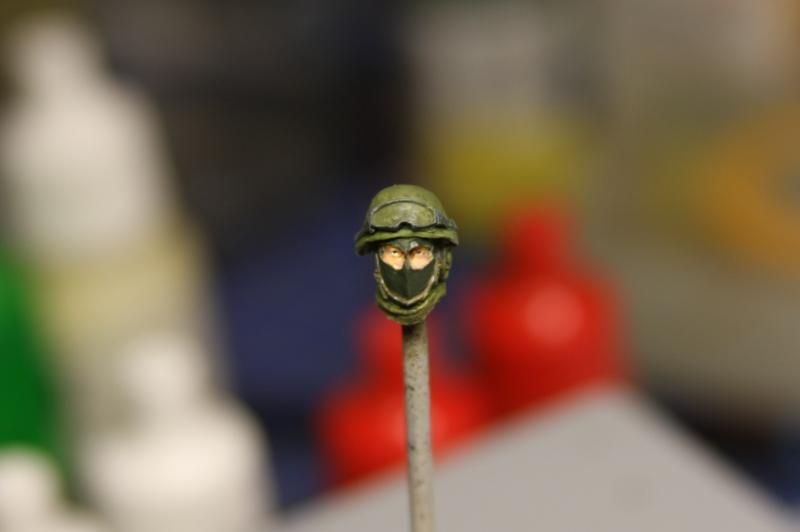

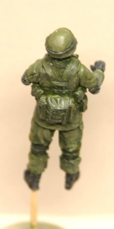

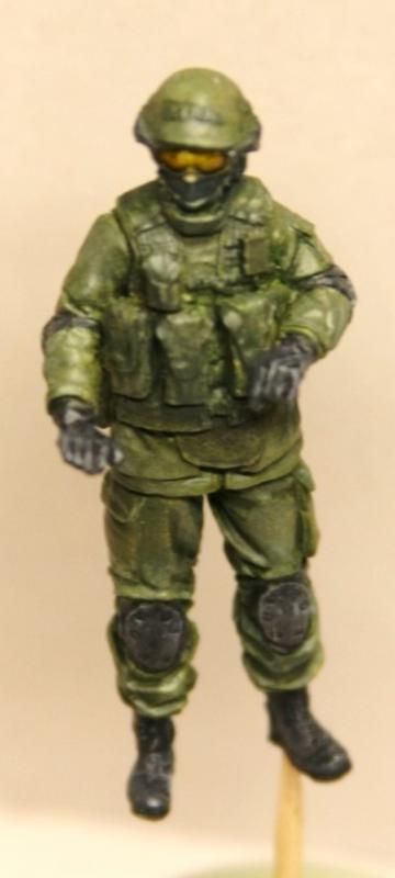

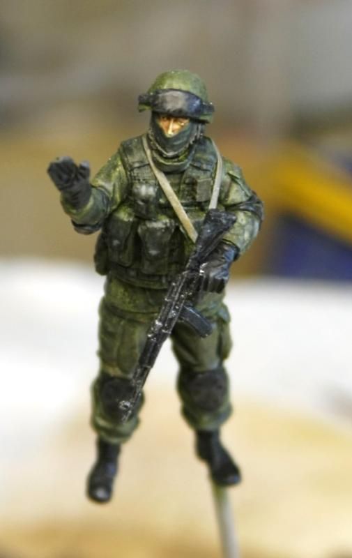

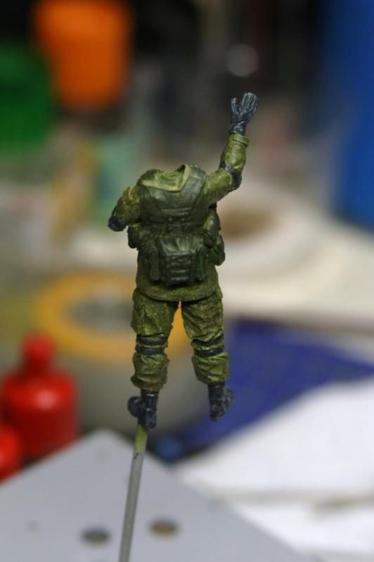

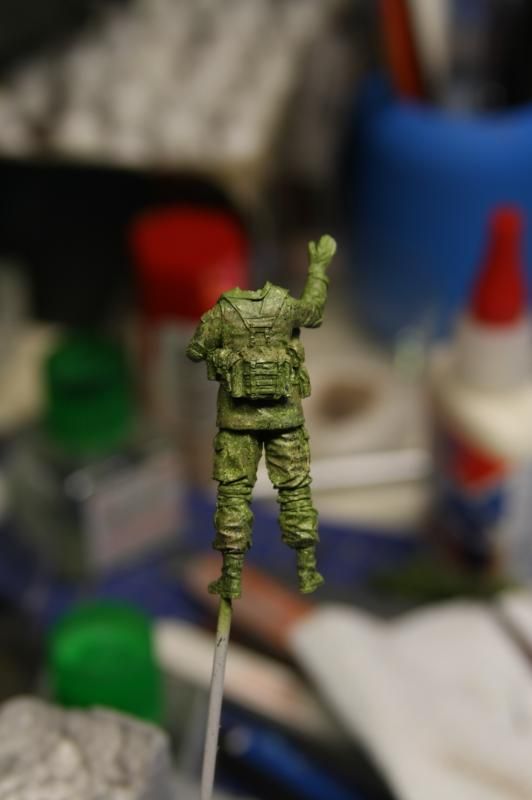

After getting the main camo colors on it was time to pick out the various areas of detail. The knee and elbow pads I did in black-grey- some of them were wearing green ones but I reckon that might have been too much green! Boots were painted black-grey too and so were the goggles. The pouch piping was picked out in a dark green and so were the face masks. The helmet straps were painted an olive color and the facial detail was also added. The AK slings were all in a khaki color so thats what I've gone with here.
Once all the main colors were sorted I wanted to differentiate the colors between the assault vest and the rest of the uniform. In the reference pictures most of the vests appear to be darker in terms of fabric than the rest of the uniform so I did what I call a 'color shift' where I use Windsor and Newton Slow Drying Medium to dilute a paint (dark green in this case) and then apply it in very thin coats. It is weak and barely noticeable at first but it builds with more coats into a translucent finish to give a subtle but noticeable difference without obscuring the camo colors beneath completely.
I also did a color shift using a green olive color on other parts of the uniform (pants, jacket and helmet cover) to give it a more olive green hue as per reference pictures.

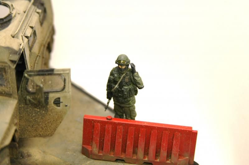

Lastly was just a bit of highlighting and shading plus final assembly and placement.

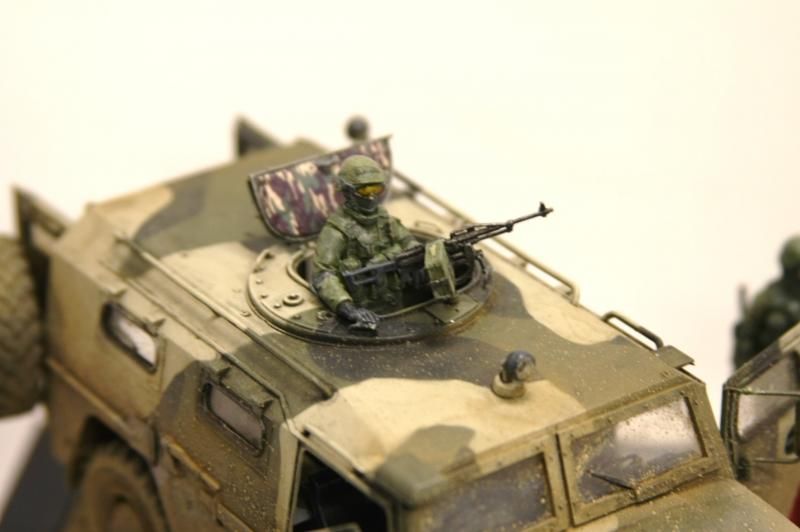

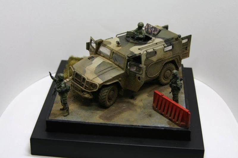

Here they are in place in their scene.
