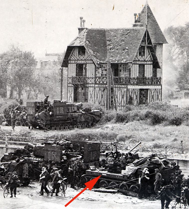

This is a neat picture:
There will be a lot more interest in this one now AFV have come out with their kit.
Would these not have been removed immediately on landing "turret cover, air vent cover on hull and hull mg cover" - again any reference pics would help. I had added a cover for the hull MG!!

hi alan
yes 2F LIFEGUARD 82 assault squadron yes was my farthers. But no boggies attached to track guards. the tank museum have a book and its shows alot of refrenaces to mk7 but the mk4 picture is fascinating and opened my eyes .
looks like a crusader AA gun

Hi Ossie,
Your Dad landed on Nan Red then in support of the Canadians and 48 RM Commando, at least if my info is correct.
Thanks for the tank name I shall add it.
Yes, it's a good pic, and you're right that's a Crusader AA with the 40mm without the shield.
I imagine they ditched the stacks at the earliest opportunity, once the beach area was reasonable clear.

Ossie's premis that the wading stacks got dropped straight away, isn't necessarily correct as the picture above shows. There are pics of them on the beach with the stacks removed, but I assume that enemy activitity played a big part in when they got dropped off, the priority would be clearing the weapons for action.
When we look at a picture it's easy to forget that the actions took place over many hours and whilst pictures often give a date they rarely tell the time, so the mix I felt was OK.

Your's looks fantastic and will inspire me onwards. Thanks also for the combat picture so much to take in, in that shot , very atmospheric.
