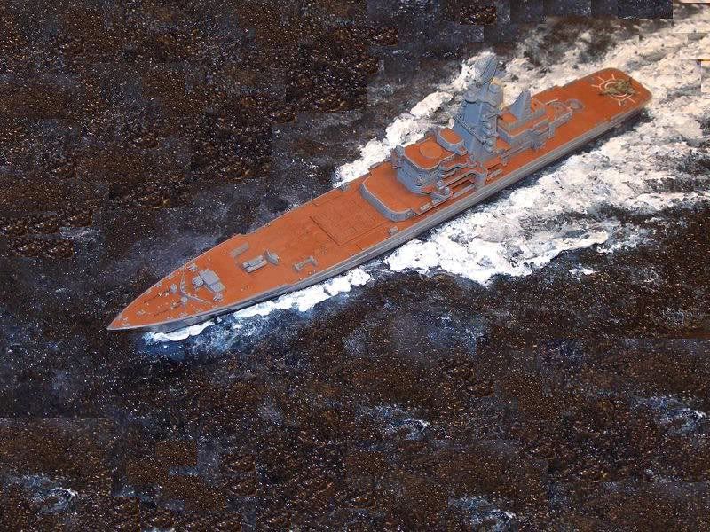

Thanks for your comments, guys! This is my first attempt, so I haven't chosen my "standard method" yet (albeit that I'm rather pleased with this attempt)! I've used "easy to work with" Acrylic paints and rather big, round brushes. This evening, I've cooled down the effects a little (it is easy to go overboard!) and added more white to the wake. Now it is time to wet the hole thing down with some glossy coats. Cheers! // PolarBear!

I'll keep you posted, Carl. I'm building the Kirov for the Cruisers campaign. I've started adding some gloss to the surface. I couldn't help doing some basic "photoshopping", just to see how it would turn out.. Cheers! // PolarBear
