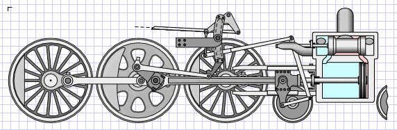

Some images that may offer clarity (or may simply add to the confusion!)
Images reproduced here fo discussion purposes only.

That second drawing does illustrate quartering but primarily speaks to an aspect I never realized regarding locomotive design: Namely that the counterweights on steam locomotive drivers appear to be slightly advanced beyond strictly 180 degrees opposite the dynamic load they are intended to offset.
I would assume this was only done on large high speed road engines. It seems to me that switchers and any engine intended to regularly operate in both directions and at slow speeds would have their counterweights set at exactly 180 degrees.
not necessarily, counterweighting the drivers is quite complicated - good insight in this discussion.

Posted: Wednesday, September 25, 2019 - 04:24 PM UTC
Very interesting blog exchange on the subject, thanks Jonathan.
Never saw drivers with holes drilled in the front face before (or at least never noticed before) but I always assumed there might be shallow holes drilled or gouged in the rear face to fine tune the balance of the drivers. Much like the the small counterweights used to balance auto tires.

Engineer's (Right) Side of locomotive, shown with "rods full down". This is the leading side of most steam engines.
Fireman's (Left) Side of Locomotive, shown "following" the right side by 90 degrees:
