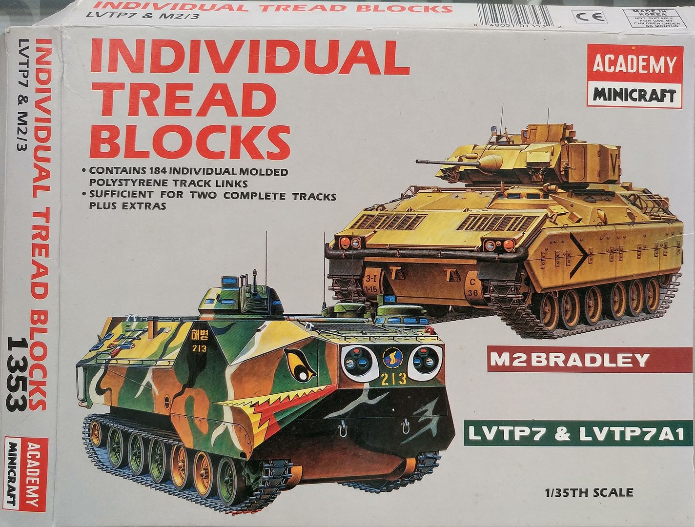

I'm doing Tamiya's AAVP7A1 and decided to replace the rubber band tracks as well. I picked up the Hobby Boss set of separate track blocks, which I'm guessing are near identical to the AFV Club set.
Unfortunately, they don't fit the Tamiya sprockets. The guide holes on the Hobby Boss blocks are set wider apart than the Tamiya sprocket teeth. Fortunately, I was able to acquire Academy's set of individual track links. They are not molded as well but they fit properly.

Could the sprocket be shimmed out to make it wider or is it the pitch of the teeth an issue?
Pitch looks right and seems to fit decent. Shimming the sprocket carrier might work. The Academy and Hobby Boss tracks appear to be size, they even (dry) fit together without issue.
Second image I placed sprocket on Hobby Boss links with teeth in inside guide holes.
Third image sprocket is on Academy links with the Hobby Boss links set right behind the Academy links.

That is definitely a possibility but, for this project I'll stick to the Academy tracks.
