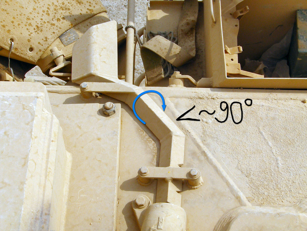

As one of the “working people” (haha!), I also ask you to keep up the great work, and to please keep posting! In addition to admiring the quality of the very small parts you are fabricating, it’s very interesting to see the collection of materials you are using! Wow -
How are you making the recently posted wire shields? I can’t tell if you are bending a piece of metal to make the shield, or, if you are using triangular material? If you are bending sheet material, the consistency in shape and size is incredible! how ever you are doing it, the result is great - or, it’s an angle piece mounted upside down? Who knows - sure looks good!

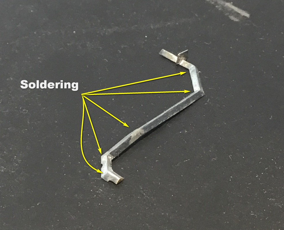

Making is simple: you cut a strip out of metal (0.3mm), 2mm wide (1mm per side) and bend under a 90 degree angle.
We cut the ends of the obtained parts under the necessary inclination and solder everything into one part. Everything is simple ...
