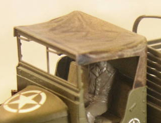

Tom do you have a recommendation for a solvent to use once the acrylic has dried? I got a coffee table I would like to get a few spots off of.
F.Y.I. Sometimes on certain surfaces the shaders will blotch up due to molecular tension in the acrylic medium so I usually add the smallest drop of dishwashing liquid to make the shaders flow out a bit better. However most of the time I don't need to.

Believe it or not, I use liquid poly glue! Just open the jar and dip the brush in for a few moments before wiping it clean on paper towel. Some brushes are ok with this, but others have bristles that curl. As for removing from a table, it might be ok with a wipe of glue on a cloth, but I suspect it would fog or even lift any varnish! Best to try it on a hidden area first...
I find the shaders flow like a good pin wash over gloss coat - Microgloss in my case. I only paint with acrylics, so cannot say how it works on enamels or oils. Beware spreading it on matte surfaces (like airbrushed paints) as it then can tint the whole area like a filter as it wicks its way through the rough texture of the paint.

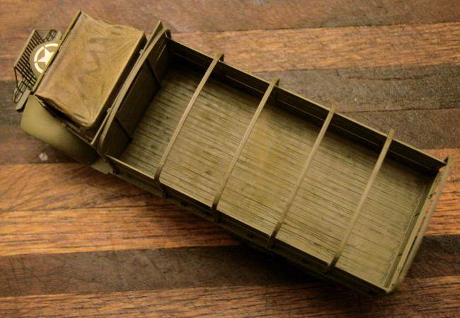

One more recent application of the Citadel shaders:
This time a single lite coating of Nuln Oil (Black) over the standard US WWII Olive Drab on the load box floor gives a nice "used" look to the flooring. Then I used multiple coats of the Agrax Earthshade (Brown) over a base coat of Dark German Yellow for the cab's cloth top.
