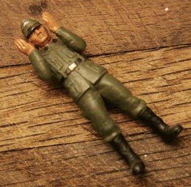

Posted: Friday, February 01, 2019 - 02:05 PM UTC
Here is a direction I NEVER thought this thread would be going in!
I hate figure painting!
I hate it because I am no good at it!
I find it totally unsatisfying because everyone else is so much better at it than me!
But maybe now I have found a trick, thanks to Citadel, that makes it at least a bearable exercise when a model just HAS to have a figure with it.
__________________________________________________
Citadel's Seraphim Sepia shader is a one coat wonder! Especially with the Tamiya figures that are molded in that warm tan color plastic of their's. One application of the Sepia gives them first of all a good flesh tone and the shader fluid runs into all the nooks and crannies of the facial expression and gives them "instant personality & character!" (With the figures molded in dark plastic you have to give them a flesh colored base coat but it is still all good!
On left a Tamiya figure cast in warm tan plastic: ------ On right an older Tamiya figure cast in dark green plastic with a flesh tone base coat:
A minor note of warning: See how with the figure on the left has such a dark colored neck? I made the mistake of standing him on his feet while he was drying. The shaders are so thin and watery that most all the pigment ran down into his neck area as it dried. If I had only known I could have hung him by his feet and he would have ended up with a nice crop of brown head hair instead!
