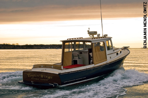

One important aspect of decks which is usually missed in plastic models is the deck camber.
In my opinion this is more important than trying to replicate wooden planking. The absence of this will be visible on a 1/700 battleship.
Deck view of the Liberty ship Jeremiah O'Brien
Link to full size image:
https://upload.wikimedia.org/wikipedia/commons/6/6f/SS_Jeremiah_O%27Brien_main_deck_5.JPG
SS Hellas Liberty. Note how the deck drops away to the side under the doors to the companionway.
The load deck of a container ship is flat though, it gets awkward to handle containers otherwise ...
Large ships
and small boats
The problem with camber on plastic models is that a flat sheet of plastic can be bent as camber (crosswise) or as sheer (lengthwise), doing both at the same time requires a lot of force or softening the plastic to allow it to adapt. To achieve both the deck needs to be molded as a three dimensional structure.
Building the deck from strips makes it easier to get the curvatures right.
