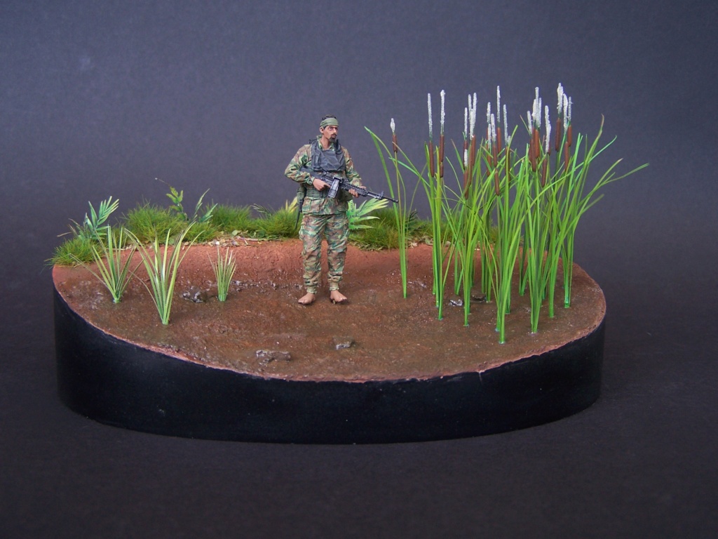

I decided to glue the dam with superglue, just in case, and applied lquid mask at the edges.
First checking with water for any leaks and to measure the needed resin.
Th resin dried nicely, but...bubbles. It appeared that, because of the hot weather, the resin started to dry very fast and the bubbles had not have enough time to get to the surface and disappear. But it is looking very nice that way
Final putty and sanding is needed on the sides of the base, and I will continue with the water ripples and other vegetation:
Cheers!

I made the dam for the resin and applied AK terrain neutral paste colored with Vietnam earth pigment. The paste cracked where it was a bit thicker, but I made corrections with а brush.
I decided to fix the dam first and the apply the paste, so there will be no leakage of the resin. The terrain can be fixed, but even smallest leak of the resin will ruin the base
Cheers!

After much sanding after several thin coats of acrylic putty, I glued the terrain to the base and painted it with black spray matt.
Next I will add the soil and the dam for the water.

Posted: Tuesday, July 16, 2019 - 07:46 PM UTC
Sorry for the long delay, I'm continuing with this one
Starting the base-a small section of riverbank (maybe Mekong river).
The oval stand is from Greenstuffworld (17x11cm), I made the terrain from insulation foam, covered with DAS clay. I will smooth the sides and apply the soil next.
Cheers!
