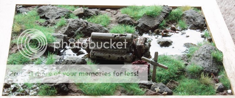

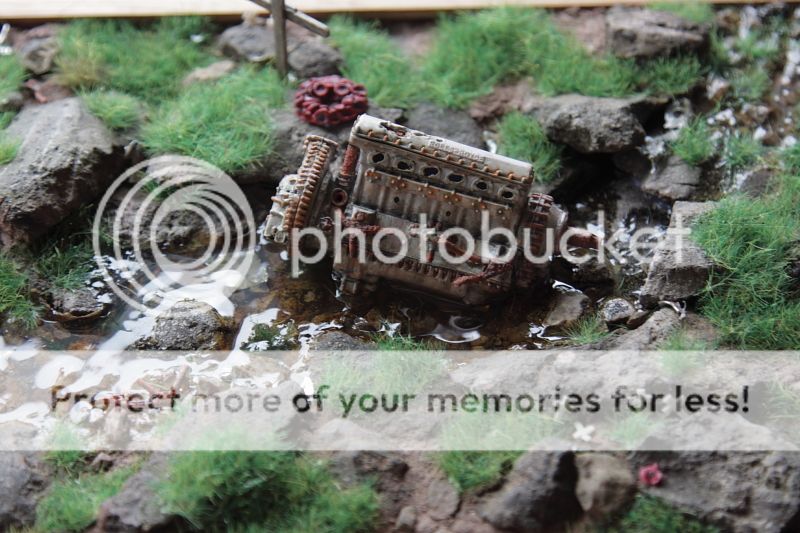

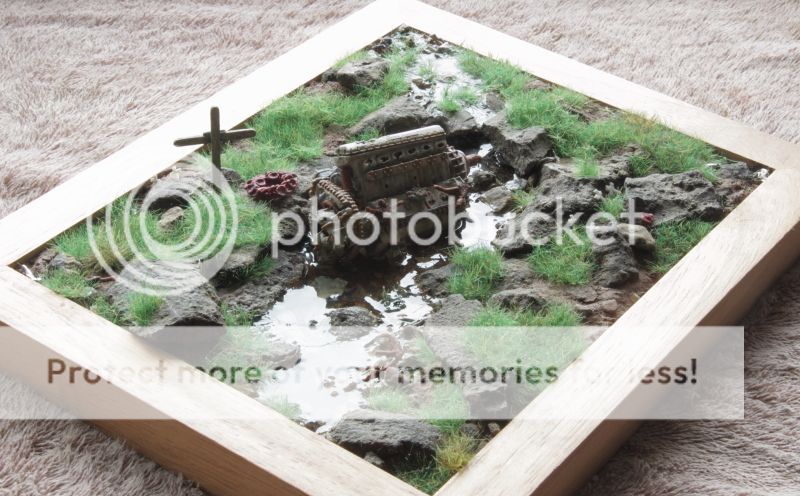

I use this for all my bases. I used to add earth coloured paint to it but was using too much.now i use paint and coloured pigments. I pour the plaster, shaping it as needed. Very easy to work with. Great for sinking tanks in. Here is one of my latest bases
