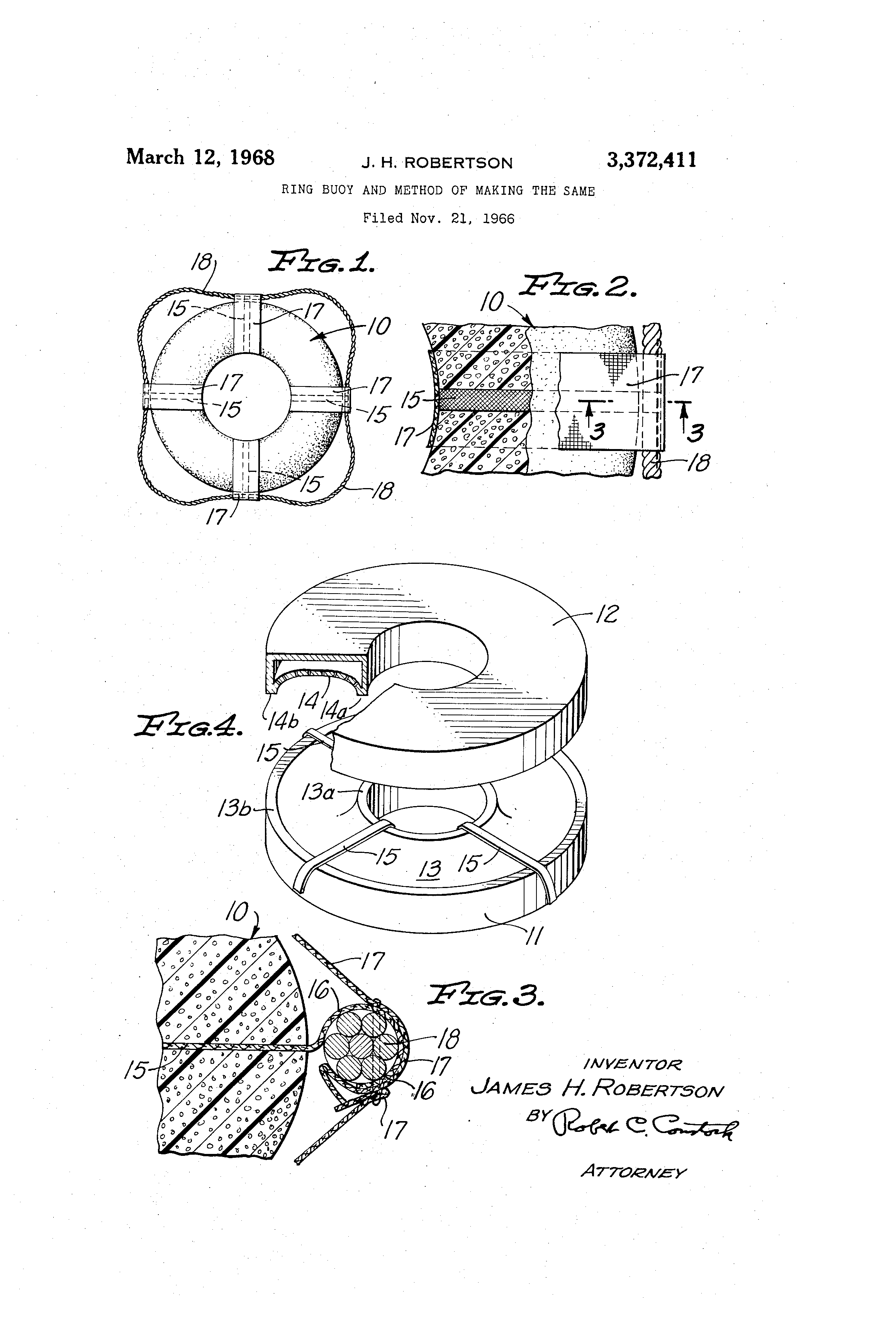

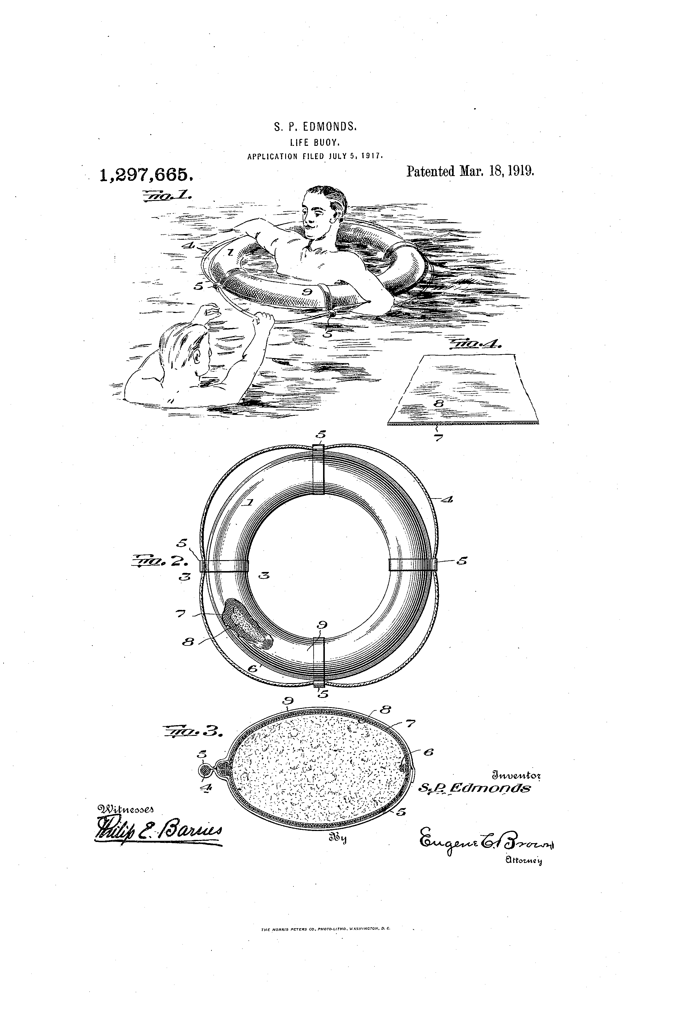

This patent drawing from 1917/1919 might be of interest:
https://www.google.com/patents/US1297665
A more recent patent of tools for making life buoys
https://www.google.com/patents/US3372411
Thick but still not near circular
https://www.google.com/patents/US831891 from 1906
The original images/drawings ae available in the patents, quite large actually ...

76 mm is 3 inches, about half of 6.3 inches
2/3:ds of 6.3 inches is about 4.2 inches or 106.6 mm
If you look closely at the examples above you might notice that some are more round than oval, same are more flat than oval. The drawing of the mold for making buoys shows a rather flattened cross section, thickness/width approximately 0.5.
For the "flattish" look I suggest scaling down from 3 inches,
for the "rounded" I suggest 10, 10.5 cm.
Still not close to 15 cm though.
The 76 mm was from memory, seeing the TryggHansa lifebuoys that can be found in various places around Sweden (TryggHansa is an insurance company, maybe they sponsor these buoys as some kind of marketing, it gets their name visible all over the place ....)
To get the correct value we would need to find the measurements used for the lifebuoys used on the ship that is being modeled.
This book might be of interest, US Coast Guard specs for life buoys. The Code of Federal Regulations of the United States of America, volume nr 46 Shipping, parts 150 to 165:
https://books.google.se/books?id=FSw7AAAAIAAJ&printsec=frontcover&source=gbs_ge_summary_r&cad=0#v=onepage&q&f=false
specifically page 97 where the measurements are given and page 98 where the construction is discussed. On page 99 you will find the requirements on buoyancy for the three sizes.
