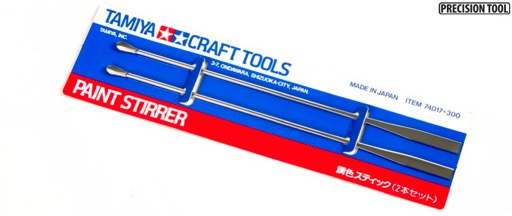

Stirrer, mixer, scraper on the cheap. 🤑

As for hand held mixers, they work well, but most do not fit into Vallejo size bottles when the tip is removed.
Kevin, The Tamiya Stirrers I show above fit into Vallejo bottles, as well as way down in the bottom of my airbrush reservoir — just twizzle between the fingers.🌪 And they're great for mixing paint on the palette as well. The electric shakers, mixers, rubber bands, batteries, ball bearings, etc. just seem too complex for such a simple task. IMHO.
Hope I didn't get off topic.
—mike

That was my thought before I got the shaker. I have found the quality of the paint I get out of the bottle after a "shaking" is so much better, makes me wonder why I did not buy one years ago.
