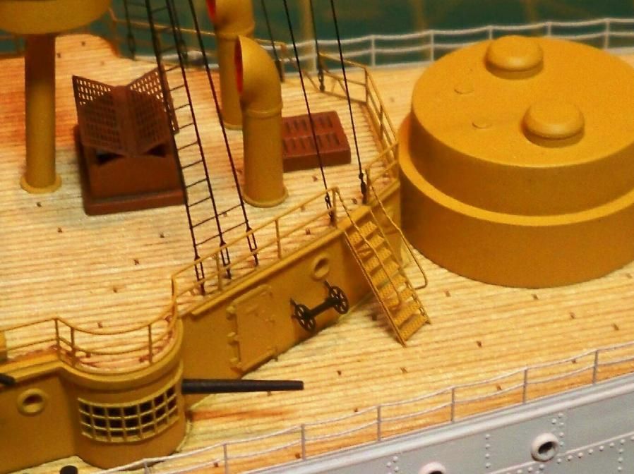

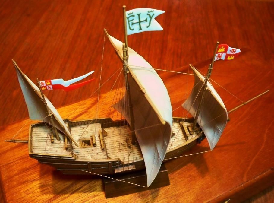

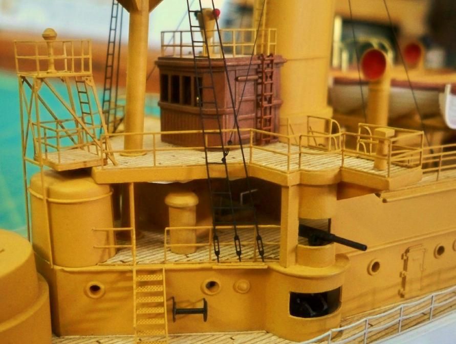

For what it's worth, I agree with both Todd and Mark; painted decks and wood veneer can both look good. I usually paint the planks on my wood decked ships, and they look fine:
The wood veneers can look even better, even though they are unavoidably over scale.
One challenge with the veneer decks is the step-up from the molded deck which can be visible on the edge. It isn't all that noticeable really, but if it bothers you it can be camouflaged with .010 X.020 inch styrene strips applied to the hull edges to raise them slightly so that the veneer deck is at a lower level behind them. That's what I did on my Revell Olympia:
It can be a bit tedious applying these strips along all the deck edges, but in the end nothing looks as much like wood... as wood!
