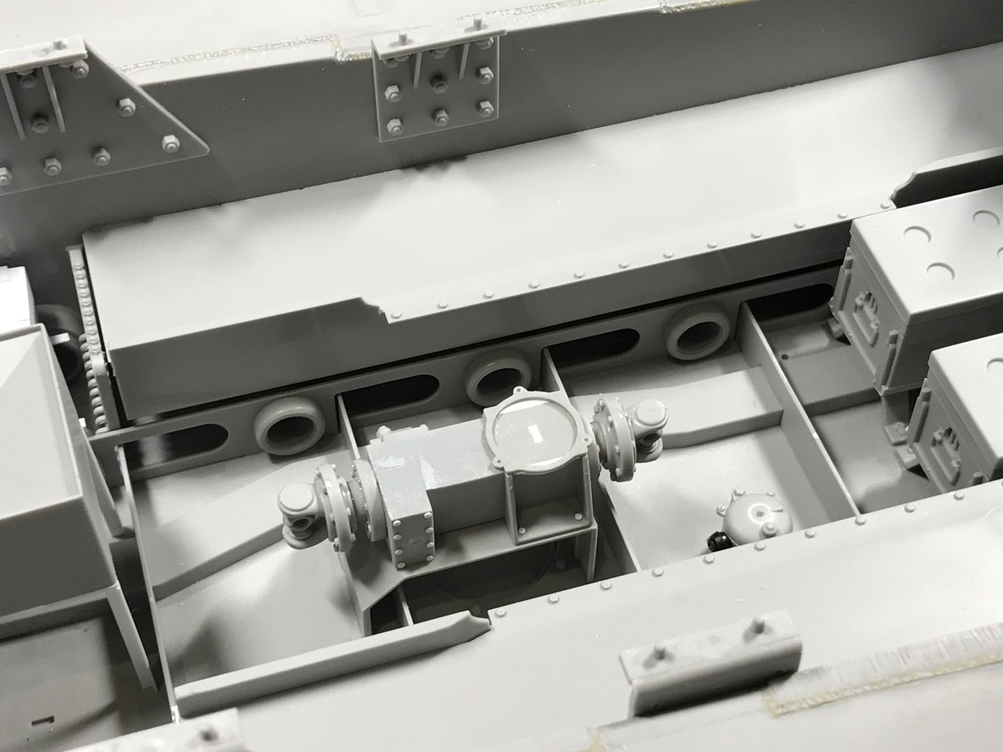

The kit has the Battery Box going under the Floor Ammo Storage Box.
I just wanted to show you guys what it looked like. I'm not going to use it as it can't be seen, that's just extra work that doesn't need doing. It's the same with the Fuel Tanks & Fuel Lines that go under the Radiators .

Very little is seen once the floor plates and under floor ammo locker is added, sadly.

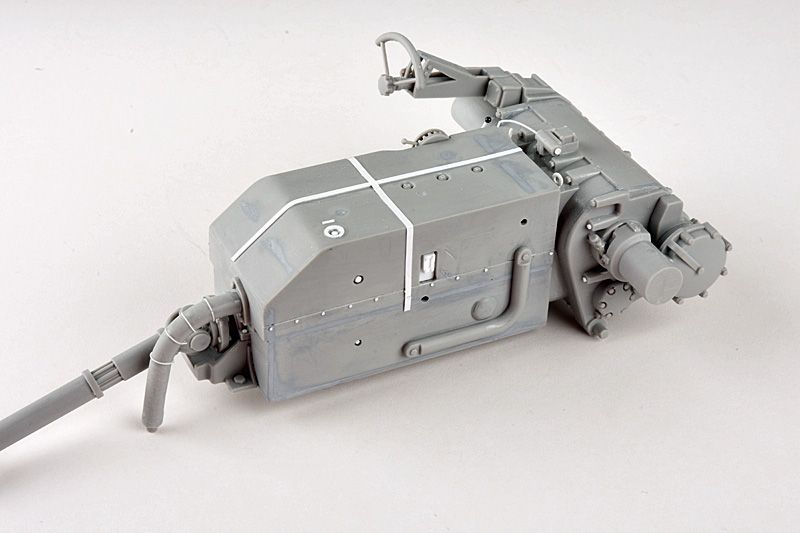

Is there some type of shield over the transmission?

Yep:

HI Dan,
Yes its on all king tigers and jagdtigers. It was a thin sheet metal cover, its use was to cover the oily bits of the transmission (obviously) but also directed cooling air over the transmission too. It was connected to a fan at the back of the vehicle and cold air was drawn in to the front section, over the transmission part then out the back of the casing via the curved pipe:

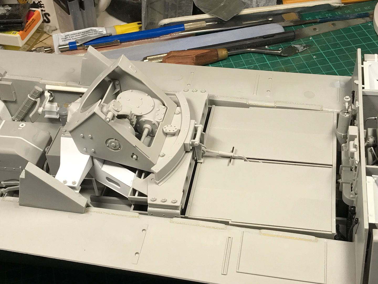

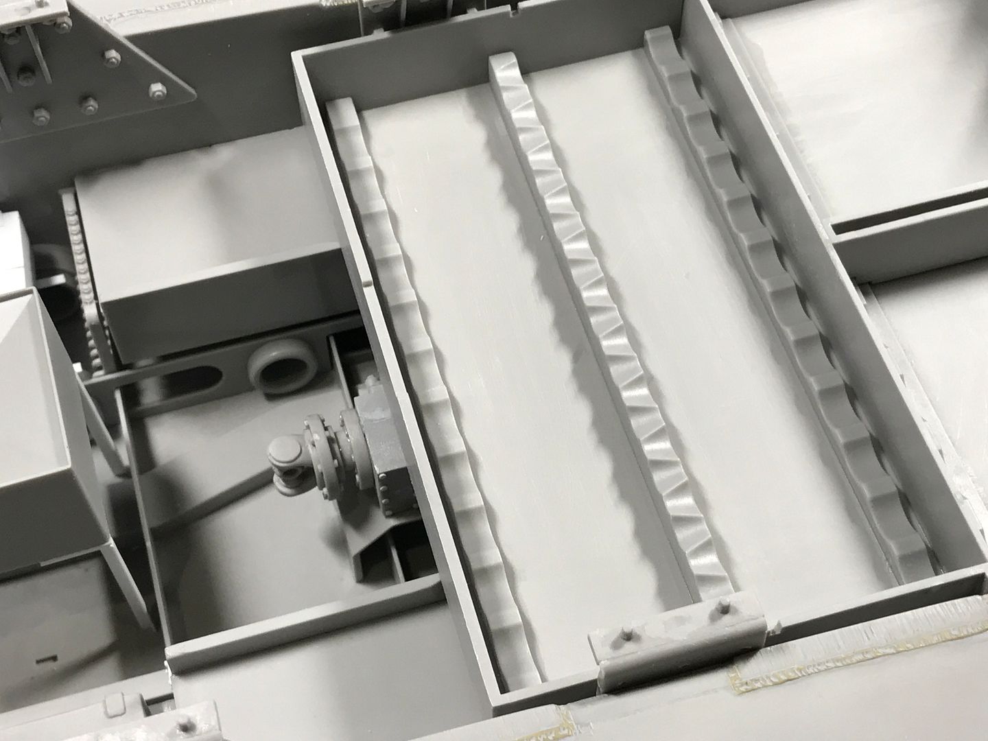

Now I'm on the Floor Ammo Box.
I used the larger of the Floor Panels thinning the slide edges.
Here the left side is slid in.
Here they are both slid in. It's obvious you wouldn't slide them both at the same time, this was just for demonstration .

I made some Handles for sliding the Floor Plates, I know they aren't accurate, but they are better than what Trumpeter gives you.
Above was folded up, and below is in the down position.

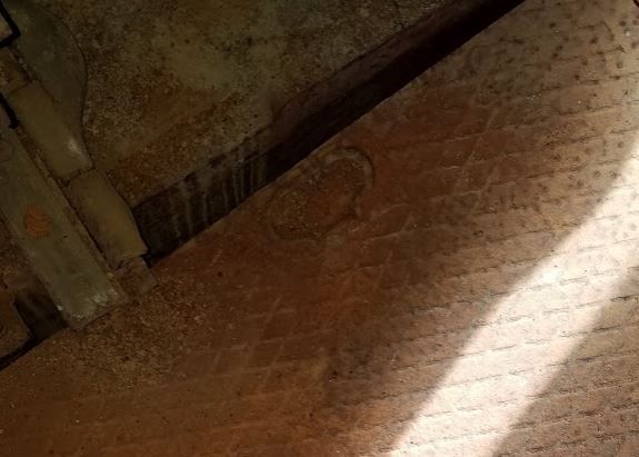

And for those of you who say the floor pannels didn't slide, here are a couple of Pics. I got off the net.
The first clearly shows the slide channel.
The second shows the open box with a round in it.
With 4 Floor pannels there wouldn't be any place for them to slide, besides they really aren't needed under the Gun Breech '

Ive been having a think about the floor plates. Perhaps they're captive in the channel that runs front and back, and that to get to the ammo underneath, you'd have to lift the plate up and slide it to one side, over the other plate its next to.
So to get to the ammo near the centre of the bin, you'd lift an inner plate, and slide it towards the hull side, over the top of the outer plate, then return it to its normal position. Same with moving the outer plate, you'd lift it up and slide it inwards, over the top of the inner plate. Now obviously the handles would stop the plates from moving too far either way, as would the hull side, and the gun travel lock assembly.
Just thinking out loud here..
