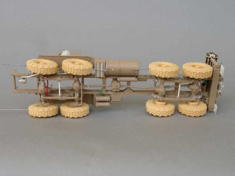

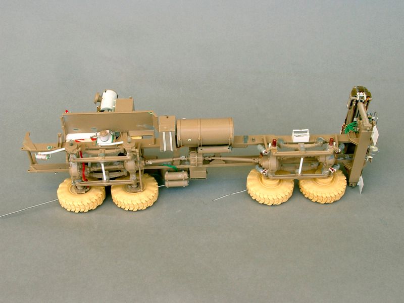

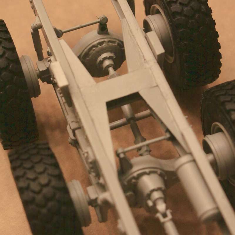

Got to wondering about the many torque rods and lateral stabilizers on the HEMTT ( one each per axle.) Then it dawned on me - my spares box of old CCKW parts. Many useful parts there!

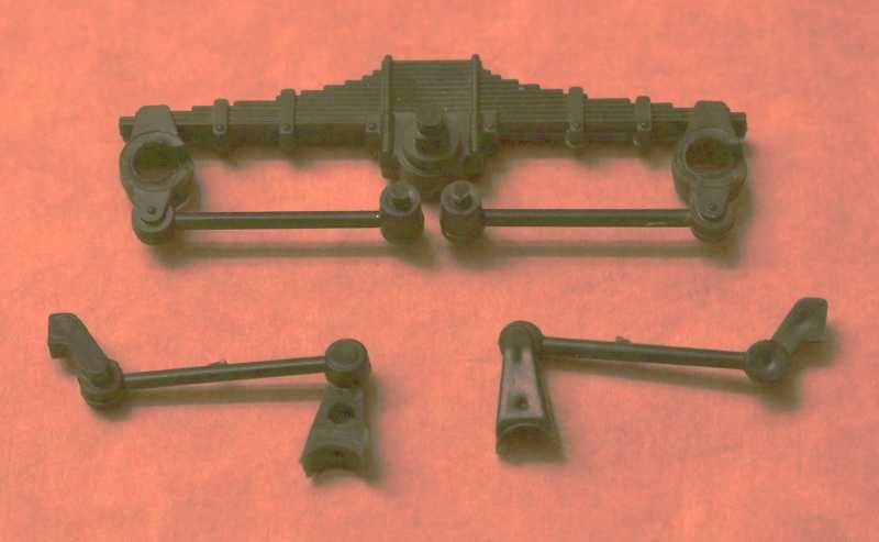

Here are the torque rods and stabilizers from the old Italeri Deuce and a half water truck of which I have many. - Having used their hard cabs to convert many a Tamiya and Hobby Boss Deuce into hard cab trucks.
I have not yet fabricated the fore/aft torque rods but here are the lateral stabilizer bars now installed - perfect!
I wish I had a similar trick for fabricating the brake actuator cylinders!

Great idea Michael. Looking great.

Thanks Taylor for backing me up, still I wish I could have done a better job on the face of that simple differential on axle #4.
I still have axle #1 yet to do maybe I will do a better job there. At least the back side of the diff is looking good with all that added bolt head detail, plus the oil check and drain plugs - that is what is really going to show under the front of that cab.
Today's assignment: working on the many torque struts (two per axle) needed for this rig!

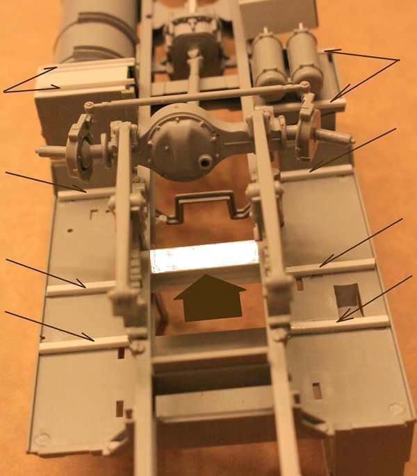

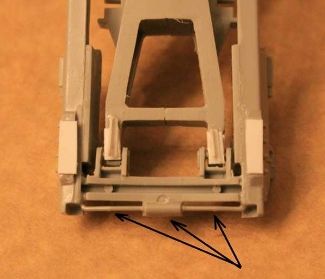

A slight problem (at least for me):
We are looking here at the rear end of the LHS sub-frame.
. . . . . . . . . . . . . TOP VIEW . . . . . . . . . . . . . . . . . . . . . . . . . . . BOTTOM VIEW . . . . . . . . . . . . .
There was confusion in the instruction sheet (or I thought so anyway) as to just where part #14 E was supposed to go. I held off gluing it on until I saw the real device installed in one of the Prime Portal reference photos.
Link to reference photo:
http://data4.primeportal.net/hemtt2/dieter_krause/m1120_lhs/images/m1120_lhs_12_of_92.jpg

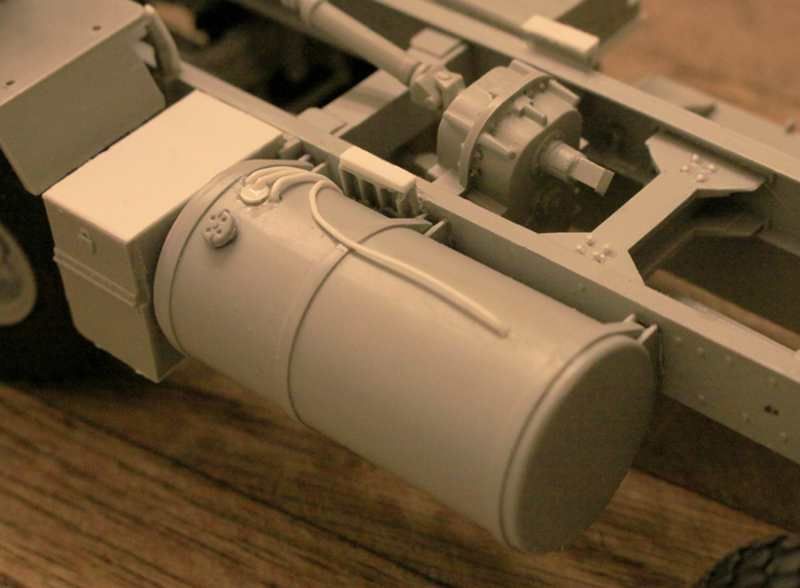

A little bit more progress tonight:
I just followed the reference photos you guys have helped provide but I am really enjoying how this fuel tank turned out. Put some serious work into removing that center seam line in the tank. A lot of sanding and many coats of primer.

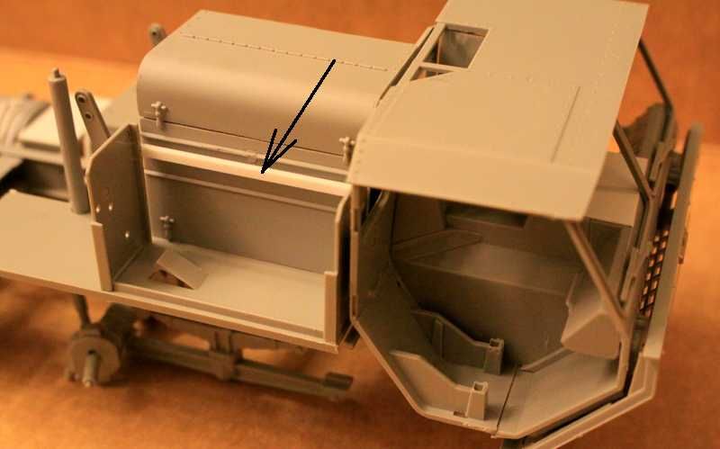

In modern CAD design systems there is a sub-routine called something like "interference notification" that tells the operator whenever one part in a design overlaps or intrudes into the space or volume of another part.
As Gino was saying earlier the original HEMTT truck model was done some twenty years ago. Whatever CAD software they were using then (if any) doesn't play well with the modern CAD technology - as in no interference notification.
I know this because I had to grind off most of that beautiful LHS mounting bracket casting that runs down behind the gas tank to finally get the tank brackets to mount solidly against the frame as intended.
Just pointing out a construction problem that everyone else is going to encounter. That bracket doesn't show behind the gas tank and you have three others to enjoy anyway.

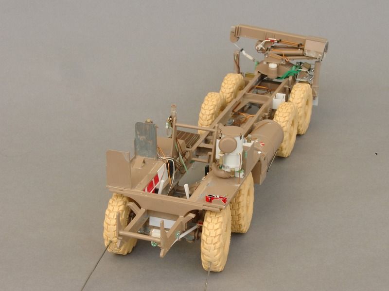

Mike unfortunately I didn't take many photos during the built so I can add only those three that you didn't seen.

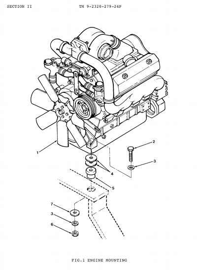

Thanks to Frenchy I how have a better Tech Manual on the HEMTT but there are still questions to find answers to, in that the manual is a mere 1459 pages!
165thspc
Kentucky, United States
Joined: April 13, 2011
KitMaker: 7,134 posts
Armorama: 6,685 posts
Posted: Wednesday, August 10, 2016 - 09:34 PM UTC

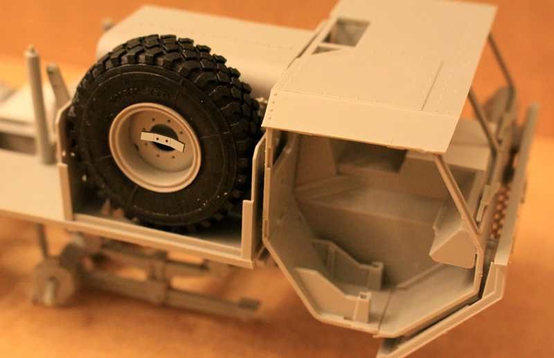

A few minor details found in the TM:
Somehow I didn't think that massive spare tire was secured by bolting it to the flimsy sheet metal engine cover as shown on the model. In reality there is a square tubing metal bar that spans between those two upright retainer walls framing the spare tire,
Also a smaller cross bar in front of the tire that bolts to the retainer bar to lock down the spare. The model makes it look as though there is some sort of sports car spinner that retains the spare.

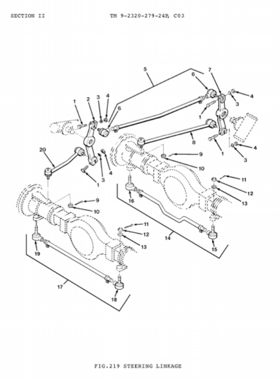

The HEMTT has two hydraulic power steering gearboxes; the main one forward under the cab and a secondary (larger) slave unit between the first and second axles that minicks the actions of the forward steering gearbox.
Note; the steering cross arm linkage on the #1 axle is BEHIND the axle in a protected position and not in front of it as represented in the model.
