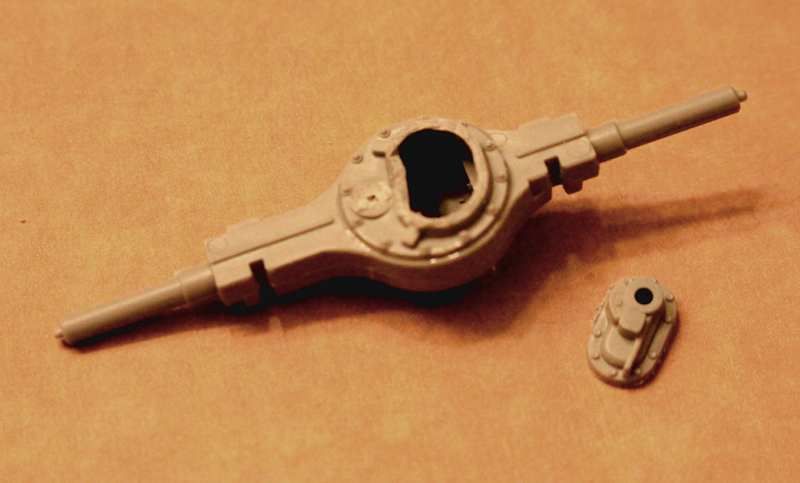

Still trying to come up with a solution for the outboard differentials. I fear anything I do will end up looking like a botch job.
This is as far as I have gotten. Whatever I produce at least it will look smaller than the other diffs, WITHOUT the gear reduction head and the drive shaft entry bearing will be more centered than it was.

Not some of my best work but I am going with it!
A pyramid of rough cut plastic circles. Plus a lot of sanding, some body putty and a lot of primer.

Looks good. I had been thinking about your post. I was going to suggest possibly cutting the domes off the axle housings from an m35 or m923 kit to use as the third member housing on your axle housings.

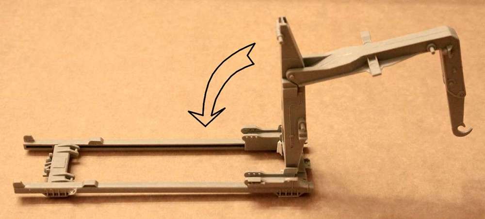

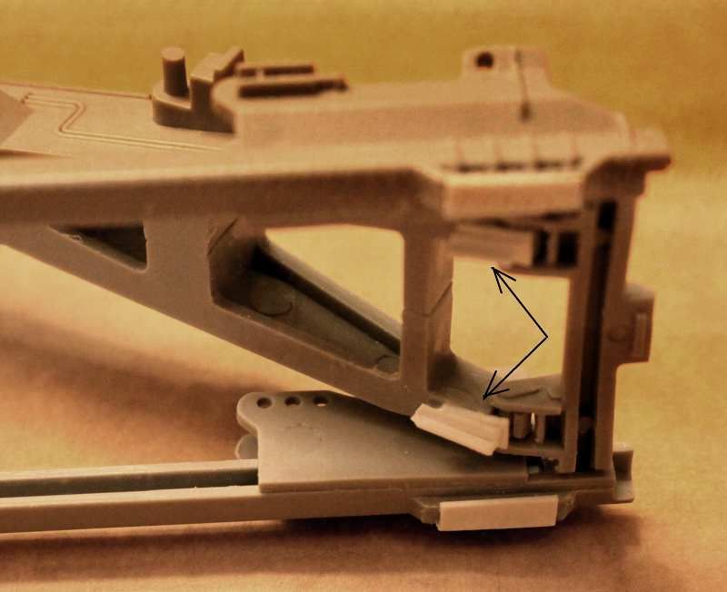

As we all know, once completed this LHS assembly has to move through almost a full 90 degrees to function. (Or at least be posable.)
I just wanted to recommend a thorough clean up of any mold lines or burrs in the area of the main hinges. I you don't succeed in getting this hinge to move freely you will end up breaking off either the hinge pins of the hinge tabs on that big main strut.
Problem: Italeri intends that this be a snap together hinge but once a proper clean up in done chances are the hinge will loose this "snap on" quality.
I recommend adding some hinge retainers below the main strut once you are happy with your clean up work and the hinge is moving freely. (Of course use caution not to get any glue muddled into the hinge itself.)

Thanks Taylor for backing me up, still I wish I could have done a better job on the face of that simple differential on axle #4.
I still have axle #1 yet to do maybe I will do a better job there. At least the back side of the diff is looking good with all that added bolt head detail, plus the oil check and drain plugs - that is what is really going to show under the front of that cab.
