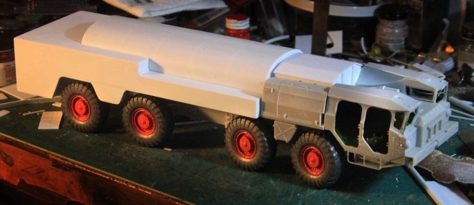

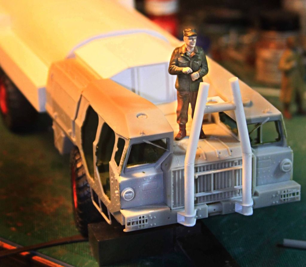

MAZ-543 AA60 Airport Fire Truck
My AA60 conversion, in process:

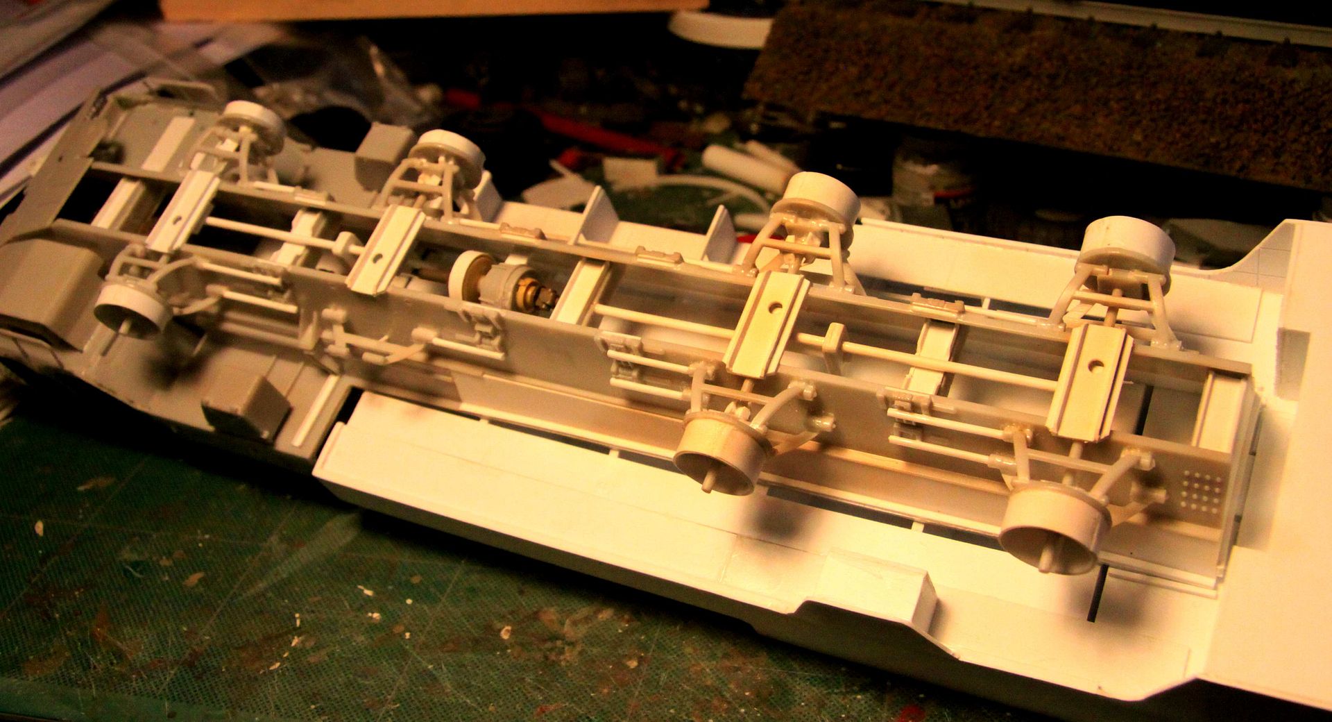

Also added at least a minimual correct underbody driveline and oil pan to the old Scud kit: (I just had to!)

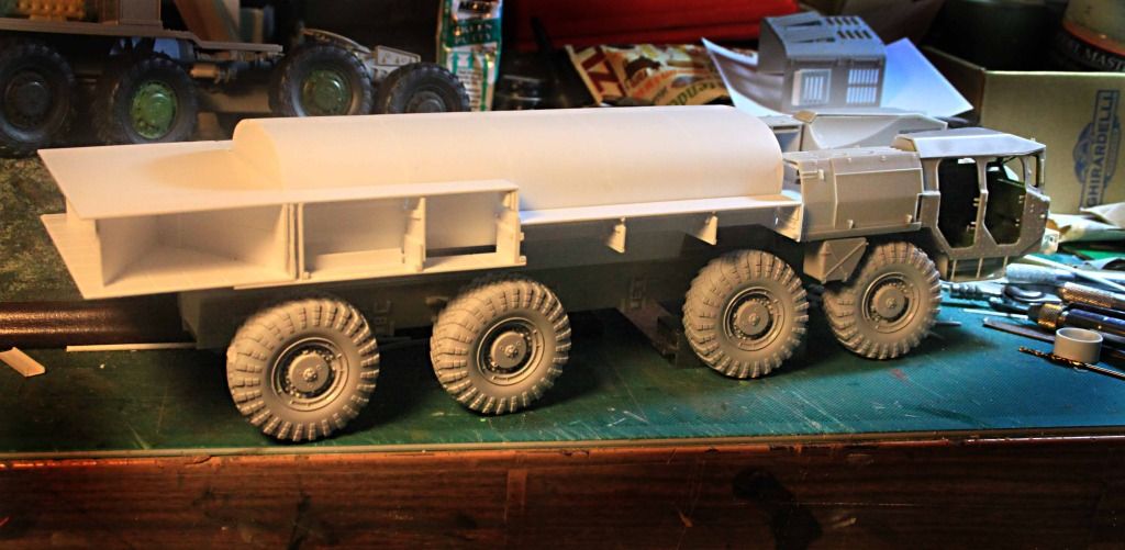

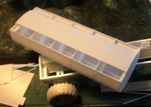

How did you get the sheet styrene to follow the curve of the bulkheads? Is it laminated sheets of .005?
165thspc
Kentucky, United States
Joined: April 13, 2011
KitMaker: 7,132 posts
Armorama: 6,683 posts
Posted: Sunday, June 26, 2016 - 06:00 PM GMT+7
Re: The MAZ AA60 fire truck construction
No Graeme, the skin of the main water tank is a single sheet of thin plastic. As I recall I just started "pre-forming" the sheet by rolling a tall spray paint can across the plastic on a soft surface like a large couch cushion. Then later I switched to a smaller diameter mandrel, using a piece of heavy broom handle to do the same thing to work the plastic into an even tighter curve. That way I progressively "teased" the plastic into a horseshoe shape that was more inclined to follow the shape of the bulkheads.
This process simulates a "three roller press" often found in old water tank foundries or shipyards. They were used to roll heavy metal sheeting into a round tube or to curve it to fit the hull of a ship.
I intentionally used very thin sheet stock because I wanted the ripple affect of the bulkheads to show through the skin once the tank was painted.
I lucked out that the cement used to attach the bulkheads to the inside of the sheet never ate thru to deface the outside surface of the sheet plastic.
Also I put plastic blocks between the bulkheads so the bulkheads were in their final form before I even started attaching the skin. Started attaching the skin along one horizontal edge. I clamped that edge and let the glue dry thoroughly before progressing to slowly attach the rest of the skin on around the bulkheads. Used rubber bands to then hold the skin in place.
Did not try to perfectly aline the skin plastic up exactly with the left and right end wall bulkheads. Just carefully cut off the excess and sanded those edges smooth after everything else had set up.
I hope that helps get you started on your project. Cheers
Mike
Ahh, that's clever, Cheers Mike. Now, if I can only remember this trick when the time comes to use it!
