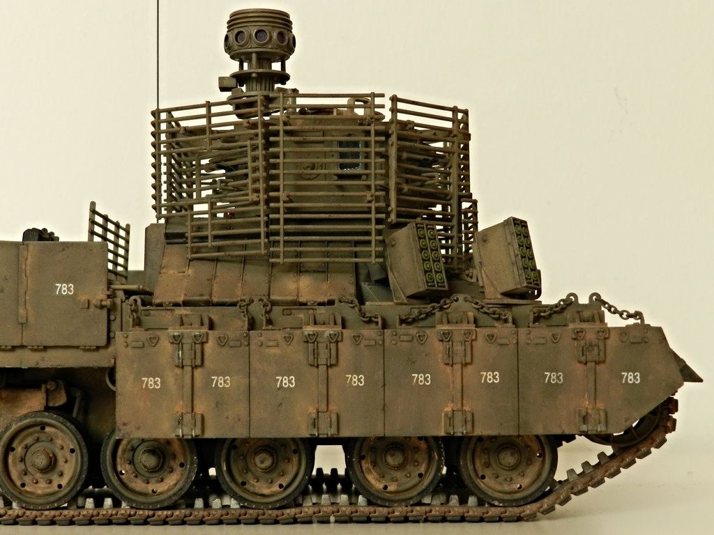

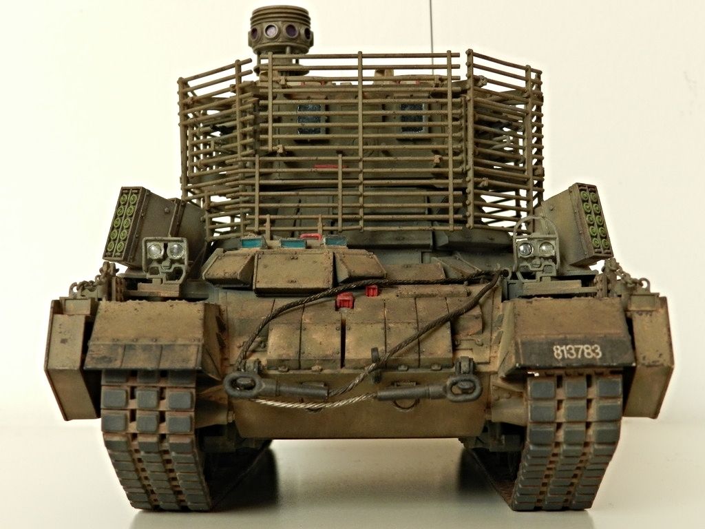

Hello Folks,
A new member checking in with a recently finished "Nagmachon".
Your input will be appreciated.

Looks really good. I have that in my stash to build as well. Did the Tiger Model go together well? How was the build itself?
Your finish does look good though!

Hi Cory,
The build was trouble free, no putty was used. The detail all around is good, the fit is great (although don't expect the latest Tamiya standards...).
I've noted a couple of mismatch in the instruction booklet, but nothing serious. As a matter of fact, the instructions are quiet good, especially for a Chinese manufacturer.
My only real complains are the rather thick slat armor and the solid mud guards, but that's nothing some scratch building (or after market PE) can not cure (I was too lazy, I wanted a quick build, so mine is 100% OOB).
The kit provides no more than three (!) different color options for the transparent parts (plain, purple and turquoise) - a complete overkill to my taste.
You'll find parts enough for two full "droids" - make sure you use the bigger one, indicated in the instructions.
Bottom line - highly recommended !

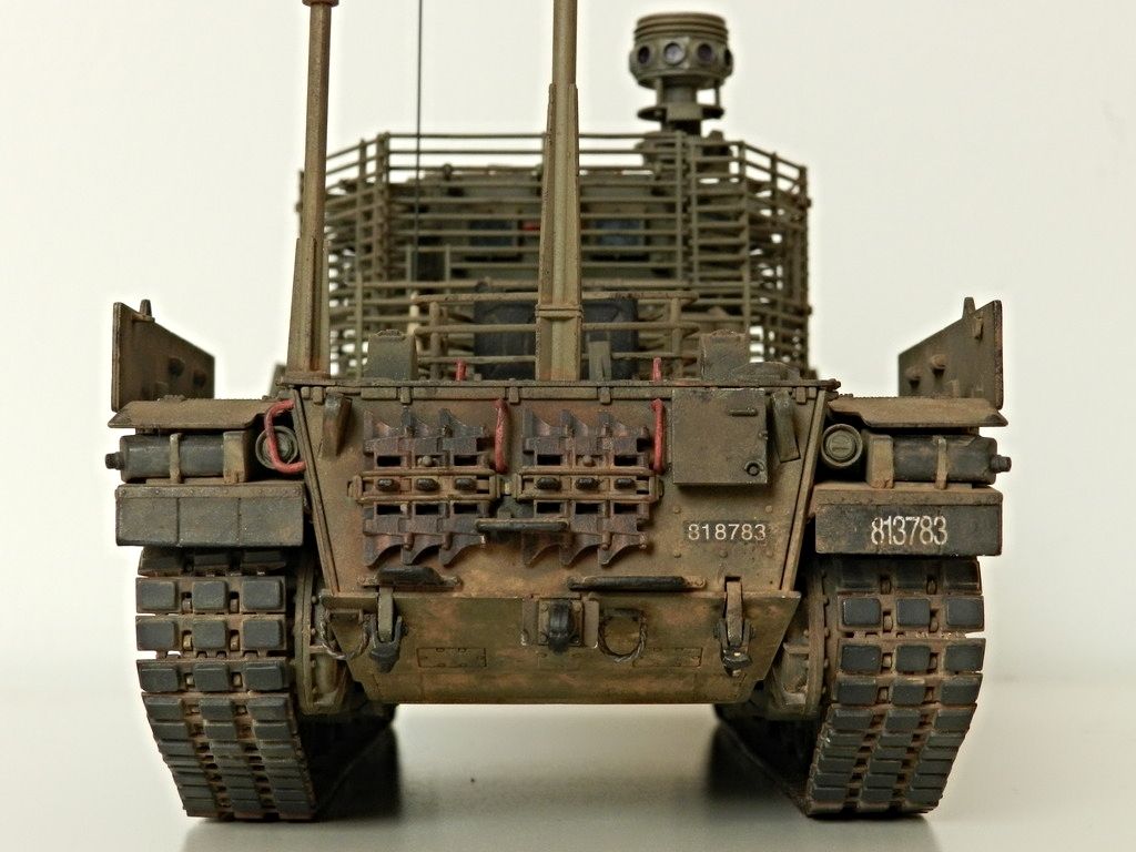

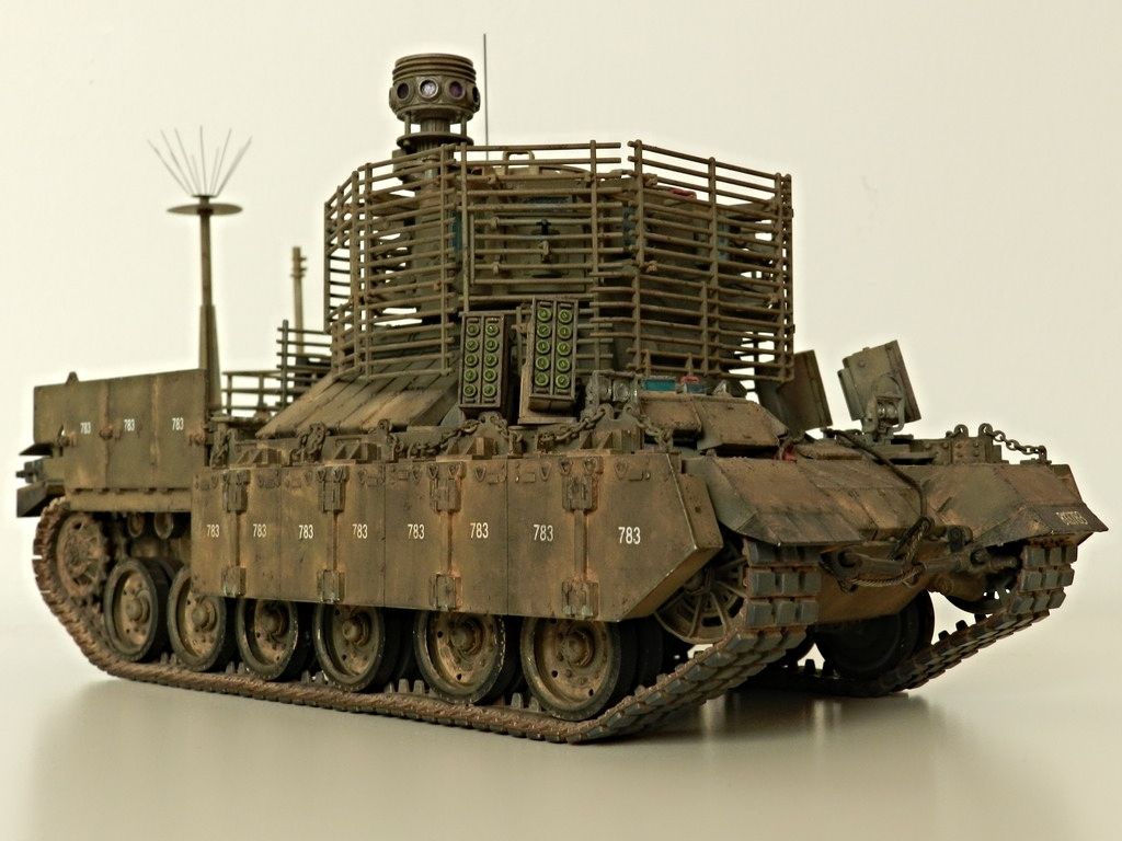

A few more pictures...
Thanks for watching,

It's a great looking model, clean built and nice weathered.

mighty Impressive,what color do you use for the paint job?

Thanks, guys !
Custom mixed Tamiya acrylics. The recommended mixture is 2 parts of XF20 to 1 part of XF49.I did not have XF20 on hand, so I used some other grey instead (can't remember which one). For the highlights I gradually added white to the base color. It's hard to see on the pictures, but I've applied at least 4 different shades on the vehicle.
According to my personal experience with IDF heavy metal, the recommended Tamiya mixture ratio is a very close match for current AFV's. Having said that, you can't really go wrong with any color that looks OK to you..IDF AFV's have the tendency to look completely different in varying light conditions.

Very detailed work and fantastic paint and weathering. A perfect combination, Nice build.

Guys, thanks for your kind words. Tiger Model has really raised the bar with this one, I'm looking forward to build another one of their kits.
Important for those who's in a process of building this kit (or plans to build it) : the number on the mud guard (813783) does not correspond to the license plate (818783). Spotted (too late, after application) by wife...does not really bother me, left it like that.

Very realistic rendering of grimy dust and wear. Are the tracks one piece vinyl or single links?

Thanks, KoSprueOne !
The tracks are (unfortunately) single, non workable links...I can never get them behave...
I wasn't aware of the existence of AFV's "Hush Puppy" set at the time of the build. Shame, as it would've made the project a lot easier.
