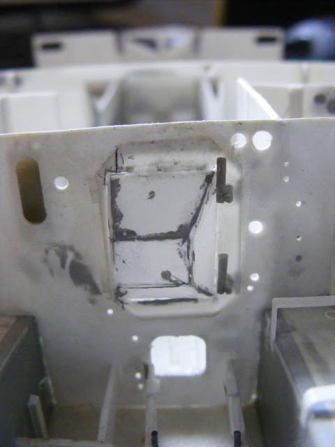

Before tackling the driver's compartment I had to correct an error:
The door in the wall behind the driver as initially built (as seen in the picture above) is incorrect, and had to be redone. The correct version can be seen below, with its enlarged, asymmetrical bulge designed to make room for the compressor of the initial motor, a modified DB603 aviation engine:

A tiny update for now. The smaller handle is for the main fuel tap, while the larger one above it is for a fuel hand-pump. These are located on the rear bulkhead, to the right of the door (looking to the back).

It was quite an involved procedure: the driver would open the main fuel tap, fuel would be pumped into the system, while the radio operator opened the main hydraulic valve located to his right front, the driver pressed the amber colored button, bringing the electric system to life with a hum. Then the ignition switch would be flicked and the Maus would roar!

Preview of the driver's left side. A switch box for the valve batteries was added to the rear wall and you can see the handles temporarily fit.
