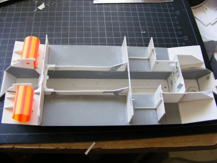

The generator area as it should look, in its complete configuration. The lid, fitted for show, and more framing will be added only after the generator is in place.

The generator had two cooling ducts that exited through a bulkhead. My "ducts", fit for show purposes, are cut from a ball-pen, I will thin down their walls substantially.

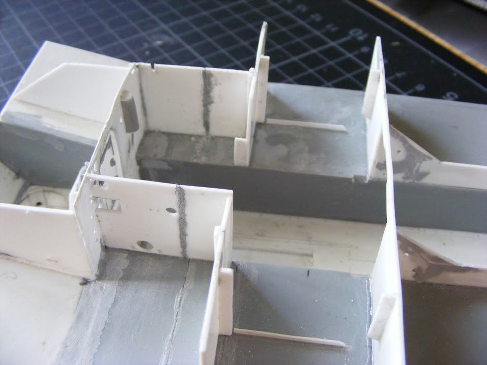

With the electric motor supports glued, the basic partitioning of the hull is now complete:

Speaking of refining and getting things right, I was not satisfied at all (quite the opposite) with the three piece bulkhead that held the exhaust air ducts for the generator(it reflects the mangled parts inside the Kubinka V1 hulk). However schematics show it in one piece and the ducts parallel. I also ignored the existence of a secondary air circuit that took warm air from the generator and evacuated it outside. The offending parts were taken down and had to start all over again, but the results are an accurate render of the prototype:

The engine compartment needed some reworking. The earlier, symmetrical configuration was based on the assumption that in November, 1944, when the V2 got the MB517 engine, both the fuel tanks were enlarged. Photographic evidence of the machine in its destroyed state shows that only the left fuel tank was enlarged.

Actually I was wrong. The fuel tank on the right was also lengthened, check out the weld mark on the bulkhead - this is the V2, in its blown up state. The short fuel tank would have ended right after the filler cap.
So back to how it looked before...

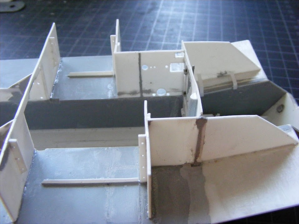

The basic, bare bones, hull layout in April 1945 would have been like this:

The second hull configuration, up to November, 1944 with only the left fuel tank enlarged, was modified as such when they changed the fuel for the Daimler Benz MB 509 from petrol to Diesel. The initial configuration (same MB 509 engine but petrol powered) was symmetrical, with smaller fuel tanks.
The final configuration (Daimler Benz MB 517 engine), with both fuel tanks enlarged and cooling space decreased.
Bulkhead, front port side. The plate that was added when they modified the MB509 to Diesel fuel can be clearly seen.
Rearmost bulkheads, between electric motors and transmission:

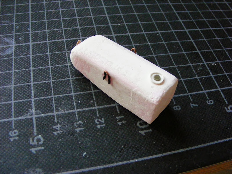

Finally got something to show! After quite a number of failed attempts at building the fuel tanks involving hammering aluminum sheet into shape (there is much to learn, but will get there eventually), building them out of styrene and Milliput (looking too damn straight), these rough shapes sculpted out of insulation material will become the fuel tanks of my little Maus (after sanding and detailing):

Woo! Another great update thanks Florin I was starting to get worried. Good idea on the insulation material I would have laminated plastic sheet together but your way is much easier! Keep the updates coming!

Now about this insulation material you are using for creating the fuel tanks just exactly what is this material made of and where did you acquire your example?
~ Eddy

No idea how it's called commercially or what it's made of, it is used for wall insulation, got it from a Home Depot type store. There were leftovers I stashed away for a future Regelbau 612 build. Stumbled upon the stash, made a try at the fuel tanks, and after too many failed attempts I'm quite pleased with the results.
This is how it looks like, it is a 2 cm thick board. It gets cut, carved and sanded easily, but if you apply too much force it tends to flake off.

I'd call the left fuel tank done (minus primer and paint), fuel lines and straps will be added when mounted on the hull, on its rubber mat:
The right one is its mirror image.
