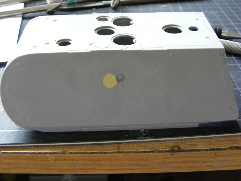

Details were drilled into the roof of the turret . The bolt holes around the loader's hatch are for securing the deep wading "Schacht" - where do you think the modern Bundeswehr Leopards got the idea from?

The loader's view port was blanked over.

There are two large rectangular welded plugs on the rear armor of Maus Wanne V1, the one with a simulated weight instead of a turret on top, these are specific to that vehicle and that vehicle alone, being ABSENT on all the subsequent hulls.
If you want to build any machine other than the V1, these MUST be puttied over.
The holes that form a square pattern in the middle of the hull are the mount points for the detachable auxiliary fuel tank.
The brackets supplied for it by the kit are way too small - two thirds their actual size. By extension so are the same brackets as rendered in the Eduard PE set 35252 for the Maus, which, by the way, is a waste of money.

The square weld marks in that picture are actually the kit's weld marks, I just covered them with putty and sanded them smooth.The holes that were plugged were for the built-in flamethrowers, items that were discarded very early in the program, but not before the plates for the V1 were cut.

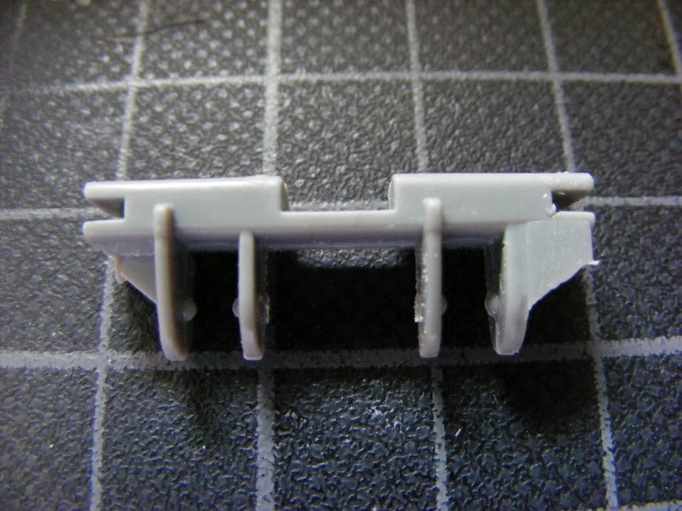

A little corrective work needs to be done on the suspension mounts.
This is how they are supplied
And this is how it looks after
Repeat times 11.
