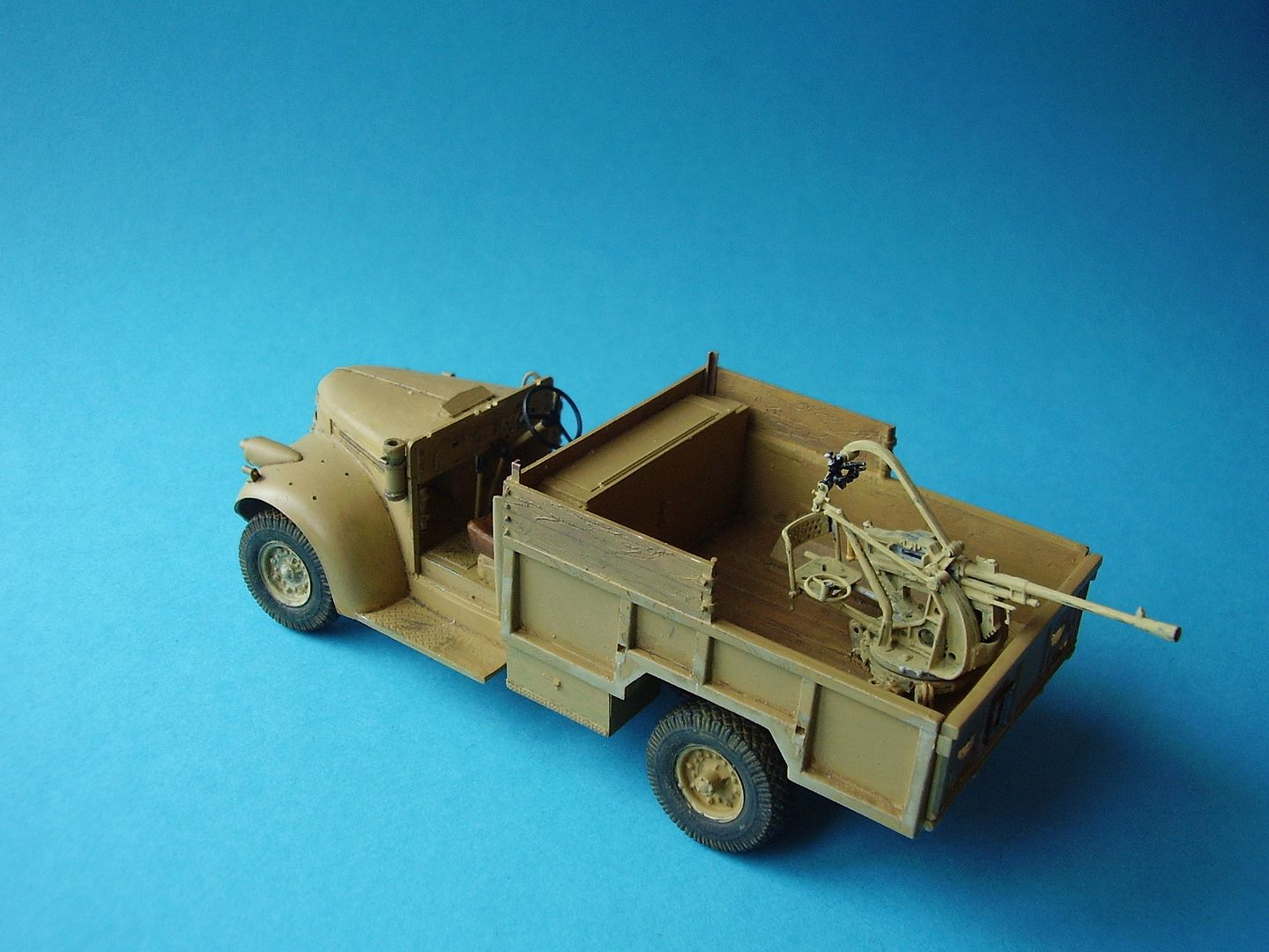

Hi Al,
Italeri have a 20mm horse drawn Breda
I'm using on for the back of my LRDG Chevy
Nice little kit.
BTW do you have any other references for the fore and aft cabins? I have a mind to add some more basic detail below .
Thanks
Alan
