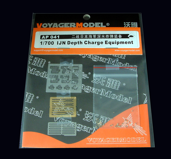

I have this set from Voyager Model, but this is intended for IJN ships...
Does anyone make some US Depth Charges in brass, Mk6 / Mk8 in 1/700?
I feel that the depth charges roller racks on USS Cassin look kind of empty and I still have to add some K-guns and racks on port and starboard side...
I tried making them in streched sprue, but they are so small that any mistake or misalignment when cutting the sprue makes me feel kind of mad (on about thirty cuts I have a 10% success rate!!!)
Any input is welcome

For the USS Cassin I am using three sets of Tom's Modelworks PE Sets, since no dedicated set is available for Mahan Class DD's. Sets are:
#701 US Destroyer Set
#713 US Destroyer Escort Set
#714 Destroyer Rail Netting
In two of these sets, roller racks, thrower racks and storage racks are included, but as I have mentioned on the first post, I feel that these are empty - so, the need for good depth charges
What I pretend is to have this look:
not like this...

In 1/700 scale (and in milimeters) each depth charge cannister should be 1.09mm in lenght and 0.75mm diameter.
As I said in the first post, I made some with cutted streched sprue but I didn't like the end result
And making a comparison with the IJN depth charges included in the Voyager set, and considering the amount of US and other allied ships that carried MK6 and Mk8 depth charges, although we have a good choice of PE roller racks and all the delicate sets, shouldn't we have available some Depth Charges also?
Just a thought for AM manufacturers

I have been talking with Herr Burkhardt and he got the plan views for Mk6 Depht Charges:
Diameter 0,65mm
Lenght 0,95mm
I have measured Mk3 Depth charges (sorry Jacob if I mislead you)
I am looking forward to see the result and get those racks filled
